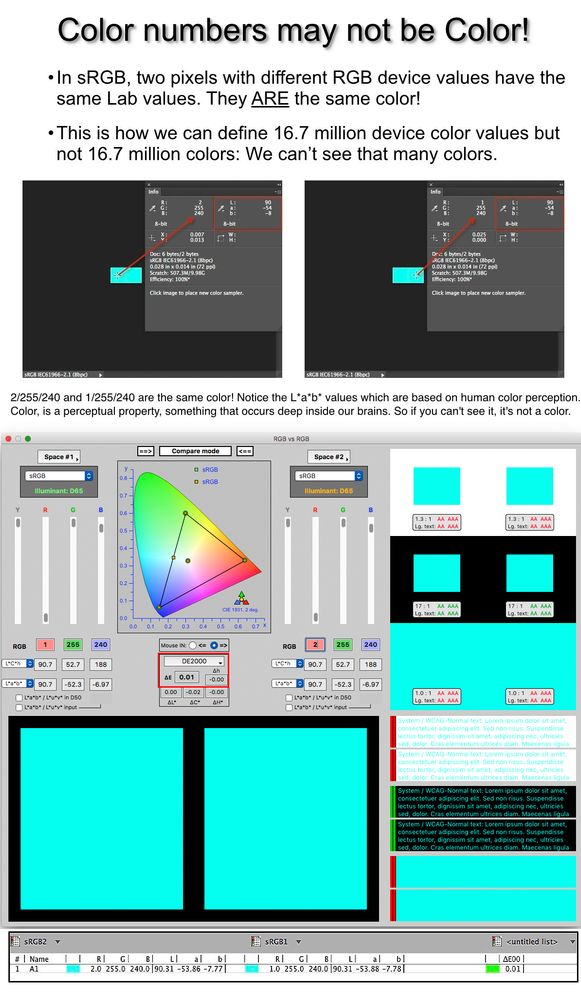

Only if you accept that colors have to be seen and that lots of numbers are not colors, or are the same colors.
There are lots of RGB triplets that are different numbers that are the same color:
ColorNumbersNotColors
There are RGB triplets that are numbers that are not colors. R0/G255/B0 in ProPhoto RGB isn't a color. It is a device value:
You're also kind of confusing colors with color numbers (device values) solely based on encoding.
As correctly outlined, if you see banding in a high bit image, its banding due to the display path, not the data. You can test this easily with this kind of image document viewed properly (at 100%) zoom:
