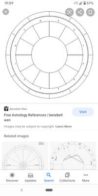

Hi there all,
I'm currently using Photoshop CC to create a template for an astrology chart. I drew a circle and then drew lines at 30° increments so that my circle is cut into 12 slices. What I now need to do is create lines to mark each degree in the entire circle—in other words, I need to draw 29 lines within each of the 12 slices. Is there an automated way for me to do this or would I have to manually go in and draw every single line? Also, if I do have to draw them all manually, how would I be able to measure them to ensure that each line is a degree apart?
Thanks in advance for any tips and suggestions!

Personally, I would do this in a vector graphics editor like Illustrator or Inkscape as you have much more control.
Or you could look for a Template.  I found this online.
Source: Freepik. com https://www.freepik.com/profile/preagreement/getstarted/6663914Source: Freepik. com https://www.freepik.com/profile/preagreement/getstarted/6663914
