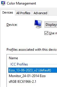

Zesty_wanderlust15A7
June 19, 2023
[Win 10] I've had a similar [cursing removed] some days ago after calibration, so calibration is not the magic trick...
A red car would look orange in PS.
Whatever I did did not fix it, or only for seconds.
There are many reports about this on the internet. Anything I tried didn't work.
What eventually worked is to keep at least two profiles in this view. I first added the sRGB, then my new and a previous one I know had worked. If I select the correct one last (and set as default), it sticks and looks correct. Should I remove the other two or the sRGB, I'm probably[cursing removed] again, which doesn't make sense.
D Fosse
June 19, 2023
What calibrator are you using? You should normally not need to go into that Windows dialog at all, much less "add" any profiles. The calibrator will set it all up - if it doesn't, it's not working.
If you do go in to check, only one profile needs to be there, and that's the one describing the actual and current response of the monitor. The profile is a map, and like any map it needs to describe the actual terrain.
Most problems people get with calibration, is that they do something when they shouldn't.
Note that if the profile is changed on system level, you have to relaunch Photoshop. It loads the profile at application startup, and keeps using that profile for the remainder of the session.

Screenshot of Color Management Control Panel
Quit and relaunch Photoshop after the control panel change, to ensure the new settings are applied.
Depending on the characteristics of your monitor display and your requirements, using sRGB or Adobe RGB here may be good enough - but no display perfectly matches either, so a custom calibration is a superior approach.
If this change to the Monitor Display profile temporarily fixes the appearance issue, it is recommended that you should now calibrate and profile the monitor properly using a calibration sensor like the i1display pro, which will create and install its own custom monitor profile. The software should install its profile correctly so there should be no need to manually set the control panel once you are doing this right.
I hope this helps
