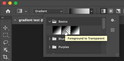

I think the problem is that it’s doing exactly what it’s told: Paint a black to white gradient into the mask. Which means paint over the mask with black to white, so whatever pixel colors were there before (that is, the existing brush stroke) are painted over.
The solution is to change what it’s being told to do. Specifically, change the white end so that it’s transparent instead of an opaque color. The way this works with gradients is that a gradient can have both color stops and opacity stops. (You see the stops when you open the Gradient Editor, or if the Properties panel is open when a gradient object is selected.) If you set the top end’s gradient stop to 0% opacity, it does not paint over anything because it’s transparent. You don’t have to set that up from scratch, because it’s already a preset. When you select a gradient preset from the options bar or Gradients panel, select the Foreground to Transparent preset, and apply that.
If a gradient object (that is, not a Classic Gradient) is already applied to the mask or layer, then you don’t have to start over, just select the opacity stop at the top end and set it to 0%. That’s the advantage of the new gradients, you can edit them later. This specific notion of transparency in a gradient is not related to whether a gradient is current (editable object) or Classic (rendered pixels), it applies to both.

Yes, of course ;), thank you! This is what I was looking for (and when the gradient overlaps the already present brush/selection elements it also doesn't interfere with them - perfect).
