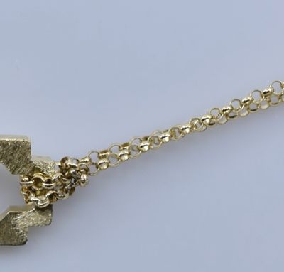

So, based on your submission you could achieve something like the screenshot attached with Photoshop. I used a combination of the following Image Adjustment methods:
  • Curves
  • Levels
  • Color Balance (all tones into warmer toning = +yellow, +red, +magenta)
As others already said, it’s much better and easier to shoot it under better circumstances with the most important thing to have a soft box (soft light, no hard/direct light) for jewelry.

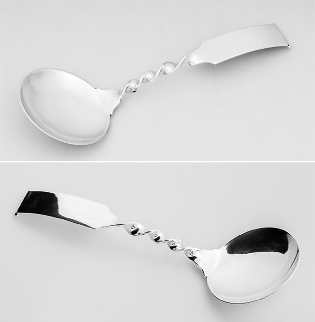

As the others said. This isn't done with Photoshop; this is done with lighting.
To get perfectly neutral and diffused light, and a clean white backdrop, you use a light tent with backlight:
Then you get something like this:
However, if you really want to show the gold/silver shiny surface, you need controlled reflections, and a play of light and dark. This can be done with large softboxes.
