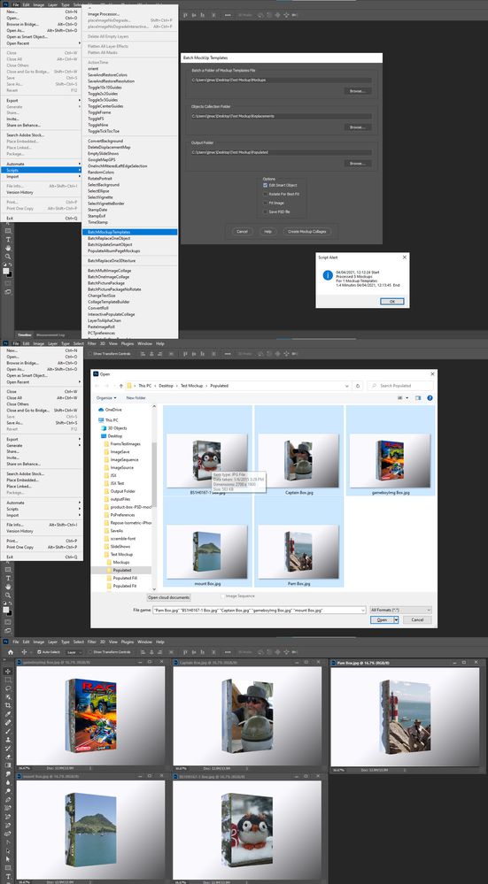

I downloaded the Mockup PSD if you look closely at the PSD you will see the top two smart object layers Fill is set to 0. These Smarts object layer have no visible content in the mockuup.  However they share smart objects that are visible in other smart object layers in the mockup template.  The reason for this is it makes it very easy you you to automate the population of the template. Only the two  smart object layer the are not visible need to be populated. All the images that need to be replaced are on the top of the layers stack.  If you look at the two smart objects layer that share the two objects. You  will see they are visible in the Template and they have perspective distortion added to the smart object layers objects transform when you use Ctrl+T free transform on these layers.  My Batch Mockup Script will have no problem populating this mockup. The bottom screen capture shows the PSD and the two smart object image files open is Photoshop.
In this Mockup template the top smart object layers have the same perspective  transform as the other smart object layers the share the objects.  This is not requited they can have any.  I have mockups where the top layer have no distorting where the the smart object layers that shared  the object may have several transform and warps in these visible  smart object layers.
JJMack

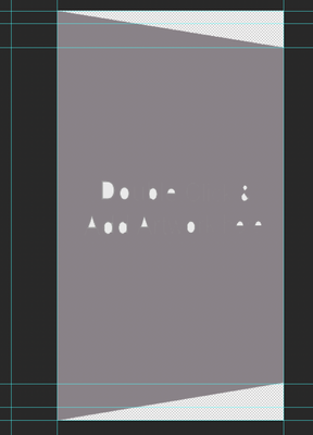

Explorer ,
Apr 04, 2021 Apr 04, 2021
I understand what you say and how to use the .psd template to edit content easily, but i still don't know how to create a similar template.
I created a new psd document, i draw a rectangle and trasformed it. Converted as smart object, but when i edit content, i  t shows the same shape, not as a rectangle.

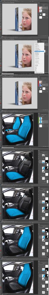

If you do not know how to create such a template you do not understand what you state you know.  See if you can understand looking at these screen captures .
JJMack
JJMack

If you transform before you create the smart object it will be the transformed version when you edit it. If you transform after you create the smart object it will open as the original shape when you edit it.
Explorer ,
This is the way to do it! Transform it after create the Smart Object!
Thank you very much!
