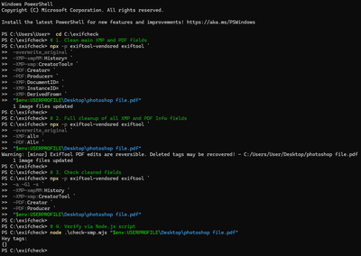

I tried using the following set of commands to clean XMP and PDF Info.
I’m attaching a screenshot of the commands and the verification file:
The XMP metadata does change, but Photoshop still behaves the same — no desired result. Any ideas?
The test file, command list, and verification file are also attached.
Based on indirect evidence, the issue is probably not in the XMP data, but in the internal PDF structures such as /PieceInfo, /Private, /Photoshop, /XObject, /Resources, and other service objects that ExifTool does not modify.
