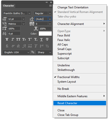

The issue you have should be the Leading setting (the input field with the thin blue highlight)
It it does not work, you can also go to the character panel hamburger menu, and select reset character.
Character panelCharacter panel

Thanks! My leading had somehow set itself to 0.01 so the cursor was just returning to the beginning of the line of text and typing over the top. Setting leading to 'auto' resolved the world back to an even keel!
