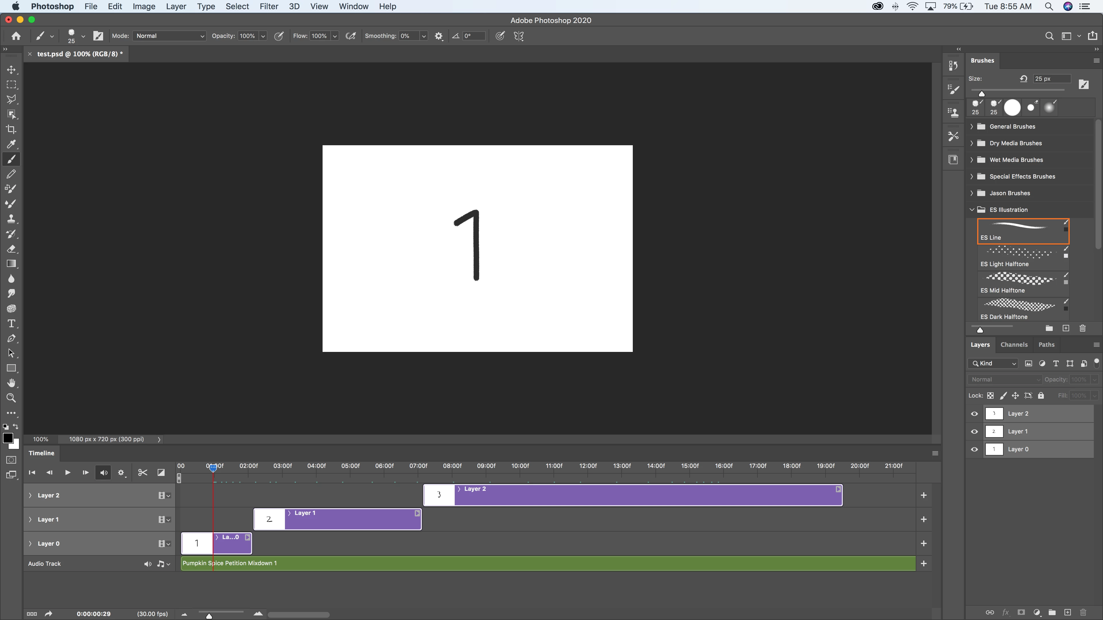

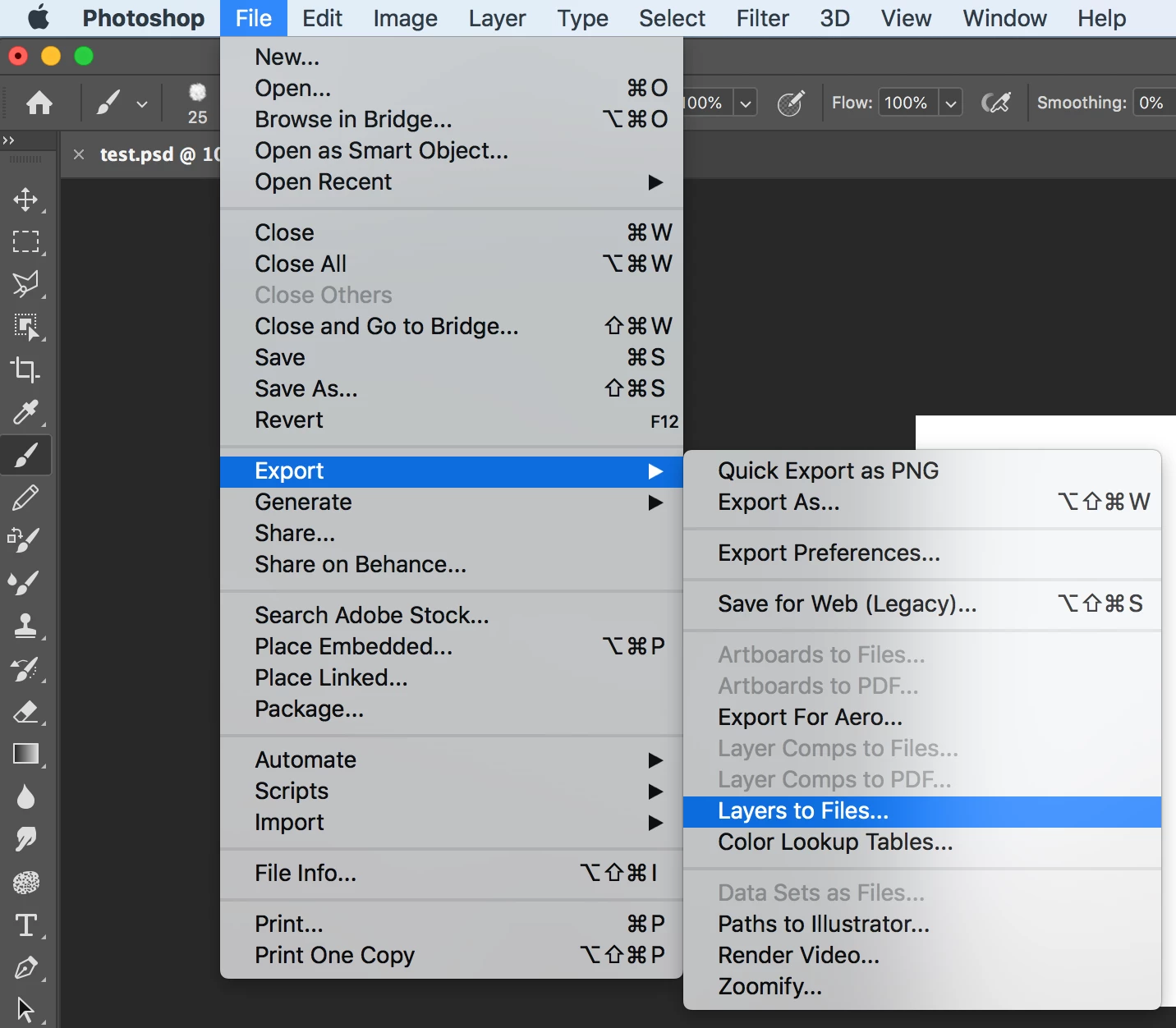

Can someone recommend how I can export my video-timeline layers to individual images?

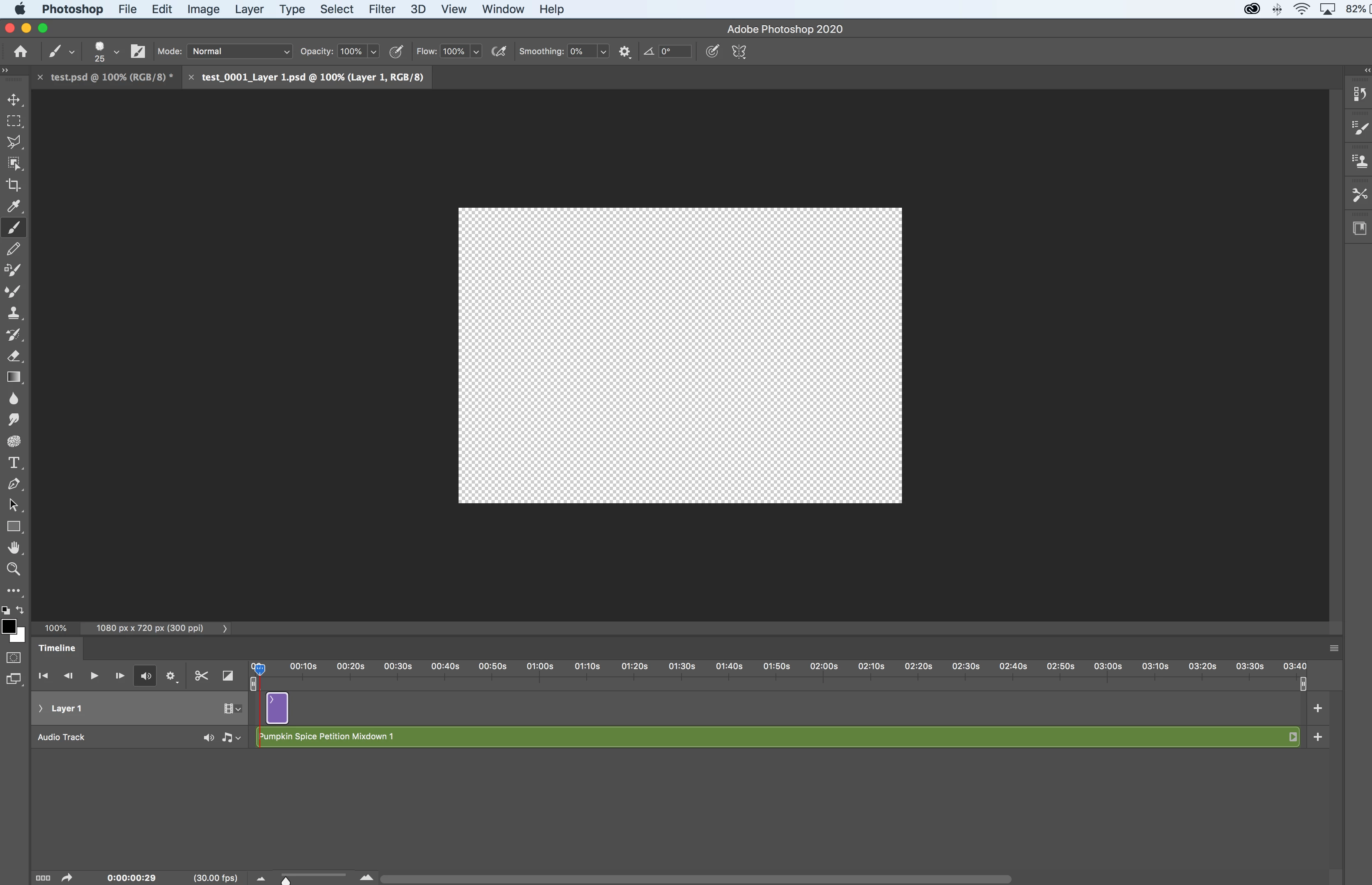

I see that when I export them, I believe Photoshop tries to preserve that layer's timeline-position, and since the playhead (presumably) is at zero for each, the exported layer's visuals will not show up (unless I export the layers as PSD, open them, enable Timeline, and then scrub to where that layer was previously situated on the mother-PSD file's timeline, if that makes sense).

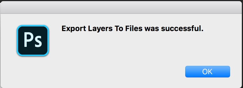

Even when I export the video timeline layers as JPEGs or PNGs, they are still blank. Any suggestions on how I can export all of my timeline layers as discreet images so I can then work with them more in Premiere/AfterEffects? I'd prefer not to render a video or full image sequence from the Photoshop video-timeline.
I noticed the opacity of every layer except the one the timeline was currently on was 0%.
Selected all layers then set opacity to 100%, then export as and it showed all my layers instead of "missing image" Hopefully that makes sense. im new.

I was having this same issue just now, searched everything, came across this thread and nothing worked.
I'm not sure if you are doing this because you didn't mention it. But I was deleting the layers in between the frames I needed. I stopped doing that, and instead shortened the timeline to the next frame I wanted. Made the cut, moved one frame, made another cut. Then repeated. Export layers to files as PNG. Started working for me.
May 10, 2023
I had the same proble and I saw the layers were set to 0% opacity. I changed it to 100% and it fixed it

I don't believe that the old Export > Layers to Files script was intended for video layers/frames.
Have you tried Export As?
