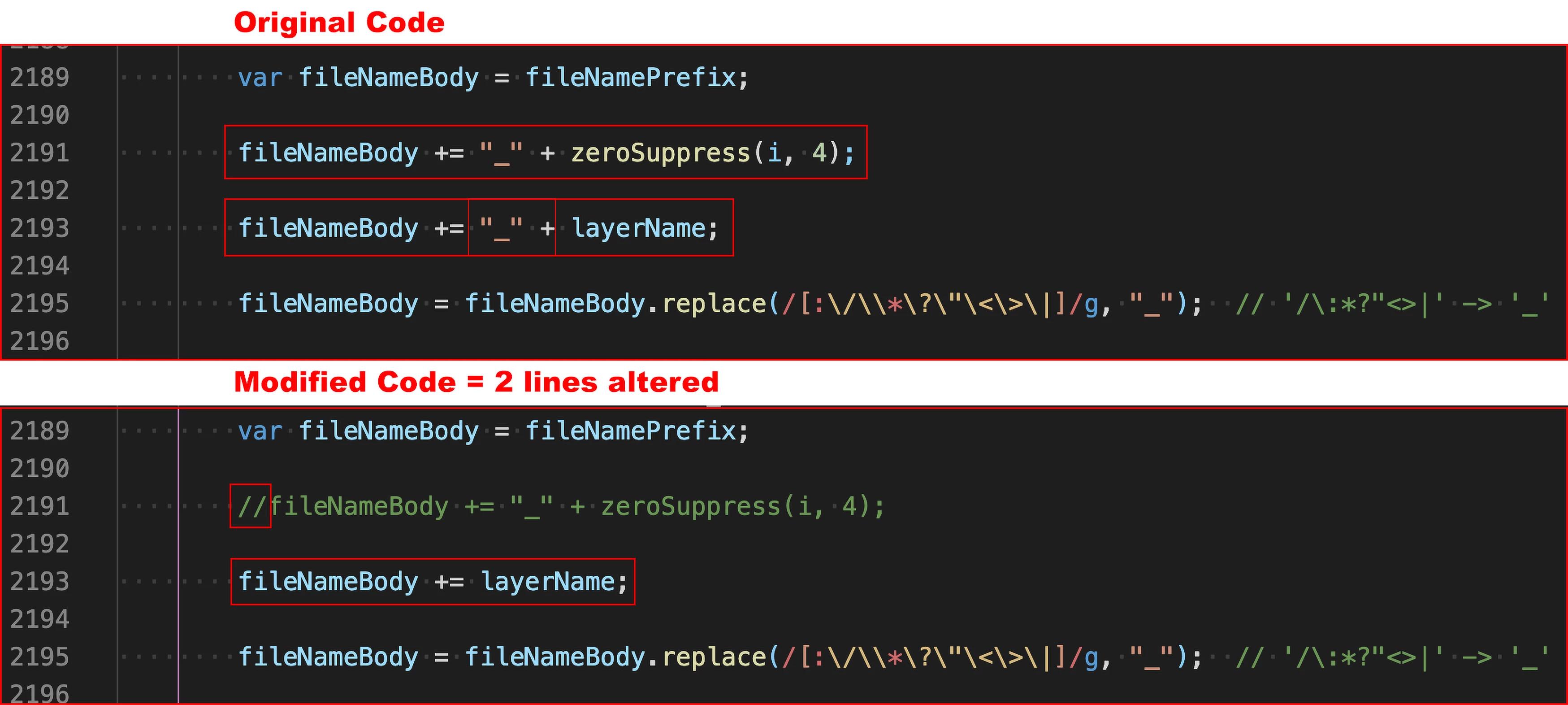

I love the option to export layers to files especially when you have a ton of headshots that all need to be the same size. However, I wish you could turn off the feature of the layers being auto numbered. The result is your file name (File Name Prefix) and auto numbering. I then have to go to the exported files and delete the numbering out of the file names. Is there a work around for this. Just like there is a check box for Visible Layers Only there should be a check box for Auto Numbering Exported Files.

Community Expert , Aug 13, 2021 Aug 13, 2021
Further to my previous reply...
The Export Layers to Files.jsx script can be modified... Working on a copy of the original script, modify the following two lines of code as detailed in the following screenshot:
Mac:
/Applications/Adobe Photoshop 2021/Presets/Scripts
Win:
C:\Program Files\Adobe\Adobe Photoshop 2021\Presets\Scripts
The onus is on you to ensure that there are no duplicate layer names as dupes will be overwritten. Hope this helps!

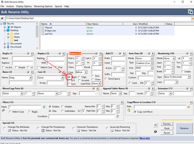

I realize this requires external software, but nonetheless you can try using a batch renaming software, like Batch Rename Utility.
If the only thing you want to remove from the names are numbers, then just tick this box:
(In Batch Rename Utility).

Thank you. I will look into this software for the MAC. I still think that they should give us the option. 🙂

However, the sequential numbers are added to create unique filenames. Consider the following example where the source file had the same layer name in more than one layer. There will be a clash.

So, as long as there are no duplicate layer names, it would be safe to remove the sequential numbers.
Mac:
Win:
