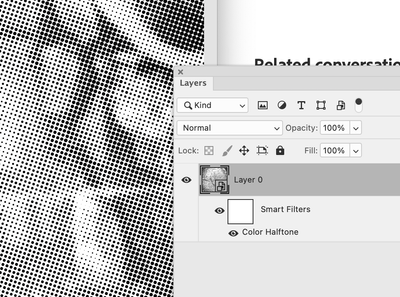

An alternative option for you, presuming a grayscale mode file:
1) Convert the layer to a smart object
2) Run the Filter > Pixelate > Color Halftone
The result will be a smart filter, which allows one to recall and adjust the settings.
EDIT: I didn't read the OP, bitmap mode would be best for actual halftone output for screenprint... However, I'd imagine that you would need 600 – 2400ppi for well formed dots.
You can record the conversion into an Action so that it can be repeated multiple times, same for entering the info into the File Info metadata.

How have you been achieving your halftone effect. There are two ways.
One is Converting to Bitmap using Image > Mode > Bitmap. This is a destructive process so there's no "record" of what you did before. What you want to do to improve the look of these is to UP your resolution to 1200 or even 2400. A true Bitmap file takes very little space so the more pixels you have to create a halftone dot, the better they will look.
The other is using the Color Haftone Filter on a Greyscale image... It's not as logical to use, it stays a a grey-scale image (you can confirm this by zooming in: you will see nice anti-aliased dots) but what it CAN do is be used as filter on a Smart Object (i.e. convert your image to a Smart Object in Layers) so it can be modified at will without baking it in.
If you truly require a bitmap image from this (I don't think you do if you're just using this effect in a larger composition), save a copy of this layered file, Convert to Bitmap ( Image > Mode > Bitmap... selecting a resolution (again, higher is better) that leaves you with attractive dots)
