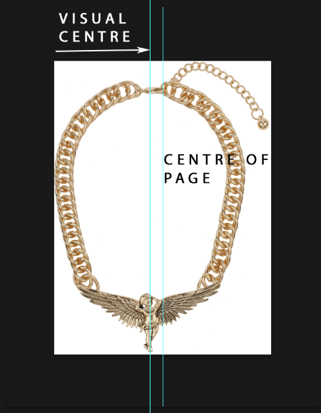

Not sure if this is possible, maybe with some maths? So possibly via applescript.
I have a layer that is this is neck piece that you see, and you can see that the extension change makes the centre, 'off centre' or at least visually?
How might I achieve this?
I need to expand the canvas afterwards to create a border where the image is framed correctly as part of an automation.

Is the part that throws off the centering always at the top of the image? Is the necklace on a layer with a mask?
Contributor ,
Aug 21, 2013 Aug 21, 2013
Yes it's always the top half of the image.
In terms of of layers from top to bottom.
Main Image
BACKGROUND
Original image (hidden)
The main image holding the necklace isn't a masked layer but can easily be one if that makes it easier.

Yes, there is a difference between the images. The script I posted doesn't really find the visual center of the image. All it does is center the widest part of the bottom half of the layer. It excludes the top half because that area is not symmetrical. To 'visually center' the width of the necklace the bottom half needs to be symmetrical. It was in your first sample and is not in this second sample.
I would be worried that any 'fix' to correct for this image would only apply to this or similar images and not work for all the images you need to center.

If the layer doesn't have a mask how does the layer's transparency help center the image? Even if you trim the transparent areas where the black border would be the bottom of the image is still off center because of the extra white on one side.
Contributor ,
The Background layer is filled white and I hide it along with the layer original image and then trim based on transparent pixels.
