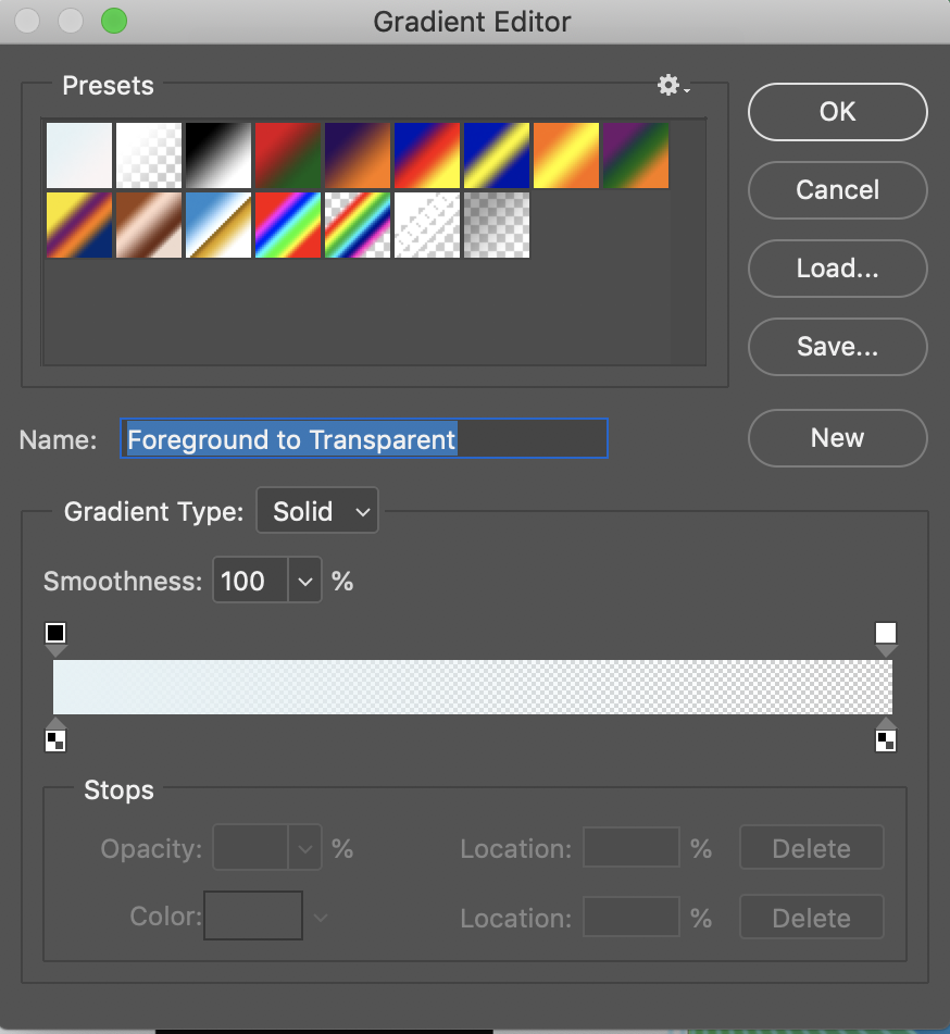

Hi all,
The other gradients will work, but for some odd reason, when I try to apply the one called "Foreground to Transparent" (white to fade) nothing happens. Its weird because the black to fade works. This gradient will work when I use gradient fill layer, but not on the mask, and I need to use the gradient layer mask.

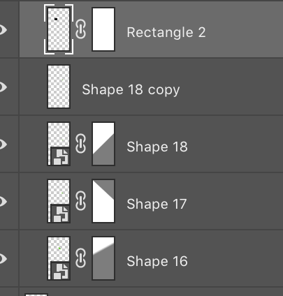

Notice the difference between other layers-the mask shows just white, no indication of any gradient
As an aside, if I try to save a gradient, then load it, the name of it comes up, but nothing happens/actually loads.
I have tried to search for the answer everywhere, but can't find it. I have tried to reset the tool several times. All settings are as they should be-transparency checked, opacity 100%
Thanks for your help

The mask is white to start with, so white, fading to white is still white. What are you trying to do with a transparent gradient on the mask?

Hi, it may be a bit hard to see but it is white to transparent (so merging into the layer color). I just want to apply a white gradient fade to the layer, like a light source, seemed like a pretty straightforward thing and I’ve done before...but literally nothing happens

Oh wait, you just mentioned the layer mask is white...ohhh...how do I change that? All I want to do is apply a gradient white to fade, on my layer in A green color. Is this not the best method then? do I have to change the layer mask color. I didnt know that, sounds confusing
Explorer ,
Dec 12, 2018 Dec 12, 2018
Maybe gradient overlay is better, I just liked using with layer mask because it’s easier to control where you want the gradient
Dec 13, 2018 Dec 13, 2018
Masks are just white, gray and black. Use can change the mask by filling it with black: have your background color set to black and press ctrl/cmd-backspace. However, with mask, I would just use a straight solid gradient. You can change the blending mode of the gradient: lighten for just applying lighter color so other white areas aren't affected, or darken for the opposite.

i Had no idea the white background would have been the issue. Unfortunately black makes mask
invisible, so will do your suggestions.
in Relieved it wasnot because my tool was buggy
