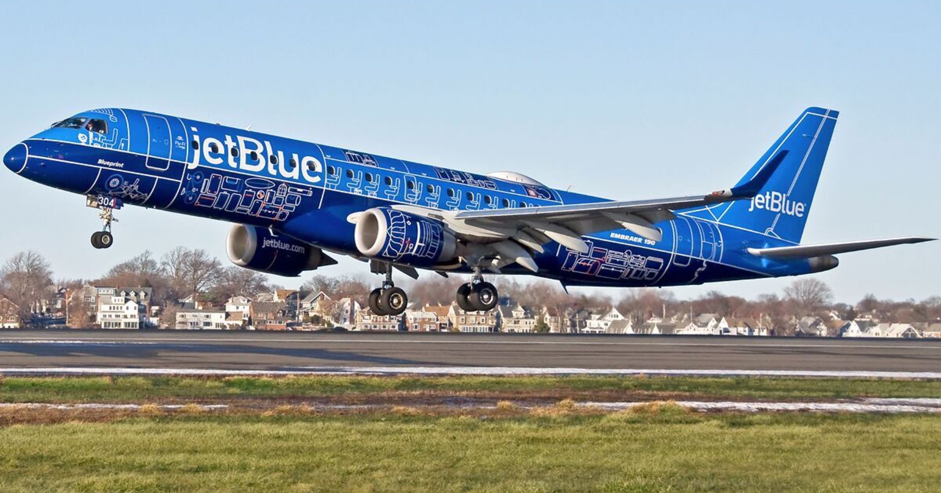

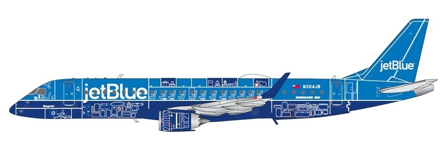

Dear PS forum,
I'm quite a newbie in Photoshop and I would like to know if I can transform a real image of a plane into something like a stylish sketch. What effects should I use if possible.
To show what I would like to achieve, I added below an example
(NB: the plane is not in the same position, but please ignore this)
Initial source:
To achieve
Basically, I would like the retain the shape of the object and lose the shading or any sort of lighting (basically to flatten the colors).
Many thanks for your help!

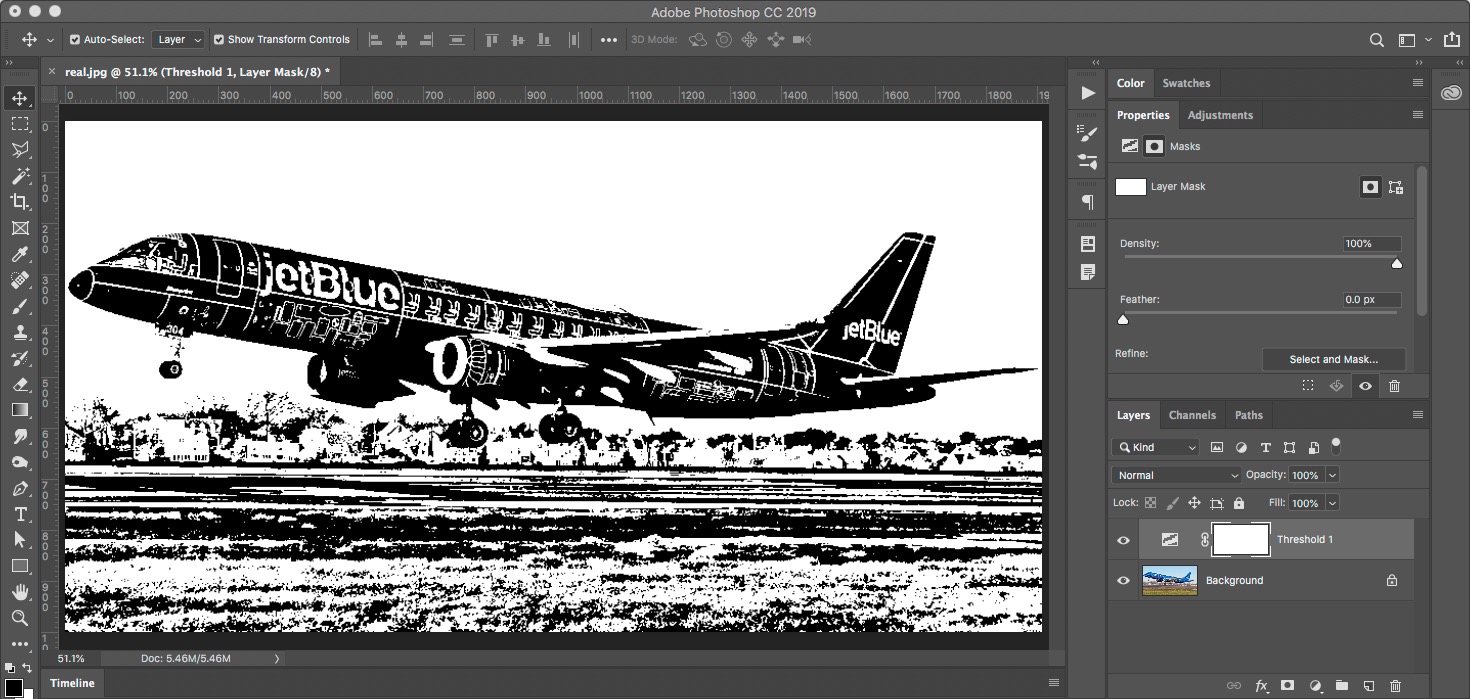

Gabriel,
Here are three different adjustment layer options that might get you in the right direction. None of them are perfect though, and all will required some manual adjustment per image.
Posterize
Threshold
Gradient Map
