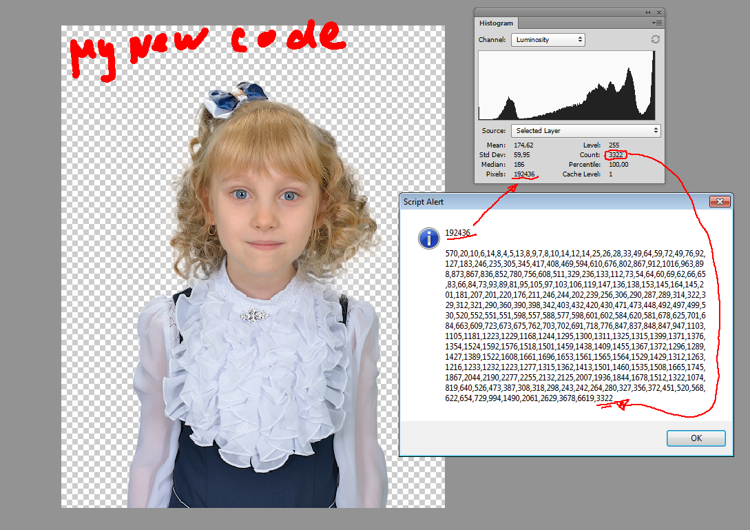

In general, I found an acceptable simple way of obtaining an accurate histogram of brightness. I combined the code from your script with mine.
In CS6 use should use shift_selection_cs6() function.
try { app.activeDocument.suspendHistory("Test", "test()") } catch(e) { alert(e); }

Another example in pictures
