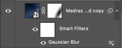

I've created a blur mask using: ( Layer > Layer Mask > Reveal All ), applying a Gaussian Blur smart filter, and using the Gradient tool on the Layer Mask.
My Layer Mask in Layers panel:
But when trying to edit the gradient layer mask by clicking on it, with the Gradient tool selected and active, the handles for editing radius, size, midpoint etc don't show. This means I have to click and drag out another gradient every time I want to make a minor edit.

Community Expert , Sep 10, 2024 Sep 10, 2024
The controls only stay there for Gradient Fill layers; masks use "Classic" gradients. To do what you want, put a Gradient Fill layer below the blurred layer, using Foreground to Transparent, with the Reverse box checked.
Hold down the Option key and position the cursor between the Gradient and Blurred layers; you should see the cursor change to a small box and a bent arrow. Click to create a Clipping Mask. The blurred layer will now use the Gradient as a mask and the Gradient maintains the edi
Hold down the Option key and position the cursor between the Gradient and Blurred layers; you should see the cursor change to a small box and a bent arrow. Click to create a Clipping Mask. The blurred layer will now use the Gradient as a mask and the Gradient maintains the editing controls.

Brilliant, that worked great. Thanks for your help!
