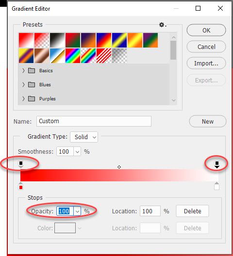

Your second image does not show that you have used Alt-click to clip the layer with the gradient to the sky layer below so you need to do that.
To prevent the original sky layer showing through - just make sure that the gradient is using opaque colours rather than opaque to transparent
If you do want to use a mask they are simple - where the mask is white the layer shows, where the mask is black the layer is transparent. So you can click on a mask in the layers panel then paint (over the image) with black , white, or grey to get the transparency you want. Similarly you can select an area and fill the mask with black or white as appropriate.
