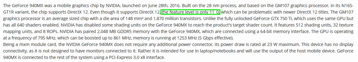

Hello Community . I have just started to work with Photoshop and InDesign. I work with a stationary PC and Nvidia card  Quadro 2000 , 8 MB RAM and it works perfect. Yesterday a bought a Lenovo laptop for home use . It is with 16 MB Ram and NVIDIA geforce 940 MX graphic card. My question is . do you think the graphic card will work with the downloaded programmes PS and In ?? . Thank you .
Correct answer Ged_Traynor
@lisen4059391 the NVIDIA geforce 940 MX feature level is only 11.0, Photoshop requires a GPU with a feature level of 12.0 and above, so the GPU is not compatiable with the most recent versions of Photoshop
https://helpx.adobe.com/ie/photoshop/system-requirements.html
InDesign should be OK
