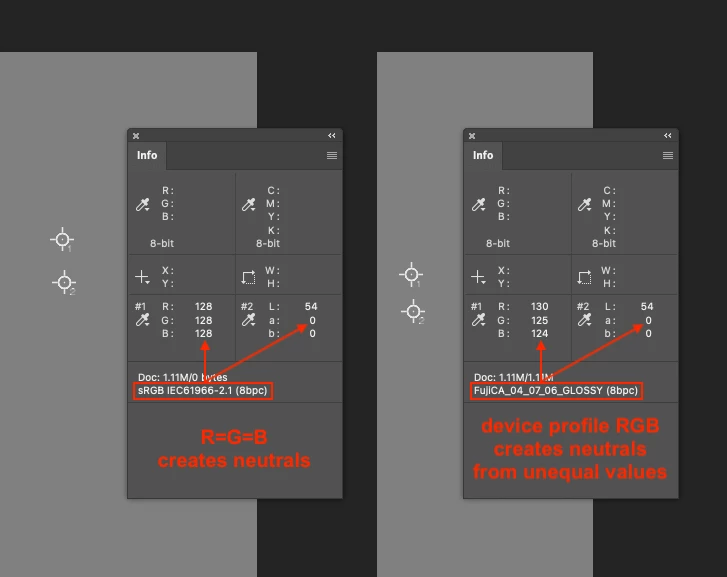

Thank you very much for your answer. I understand and yes, I´m using CMYK. Then I´ll use the channels to solve this issue, however I still have three doubts. First, any idea why I didn´t have this problem with an earlier version of PS? Even when working in CMYK the grays were grays and whent I printed everything looked like it should.
You either didn't desaturate a file in CMYK or you never noticed due to monitor calibration and not checking the numbers (Lab) in the file. It has always been this way, for any device profile, here is an example of the same issue in RGB where equal values create a neutral in a synthetic working space, however for a RGB profile of a print process different values are needed to create a neutral (zero A and zero B values in Lab colour readings of the RGB file):
My second cuestion is would it work if desaturate the images in an RGB color space an then duplicate them in the CMYK file?
Yes. Many work in a synthetic RGB working space (sRGB, Adobe RGB, ECI RGB etc) where R=G=B values create a neutral ?L 0a 0b value. They may or may not eventually convert to CMYK. But if they do convert to CMYK the R=G=B neutral values are converted to the correct device values to maintain a neutral.
The last cuestion is if there´s any way to modify the CMYK or the hue/saturation tool, maybe in adjustments
It can be challenging to adjust a CMYK file to create a neutral as the ratio of C to MY varies from light to dark tonal ranges, it is non-linear. Not impossible, just more work than it is worth when you can just convert to RGB and desaturate and then convert back to CMYK, where it would probably be better to use a heavier GCR profile for the same print condition that delivers less CMY and more K.
