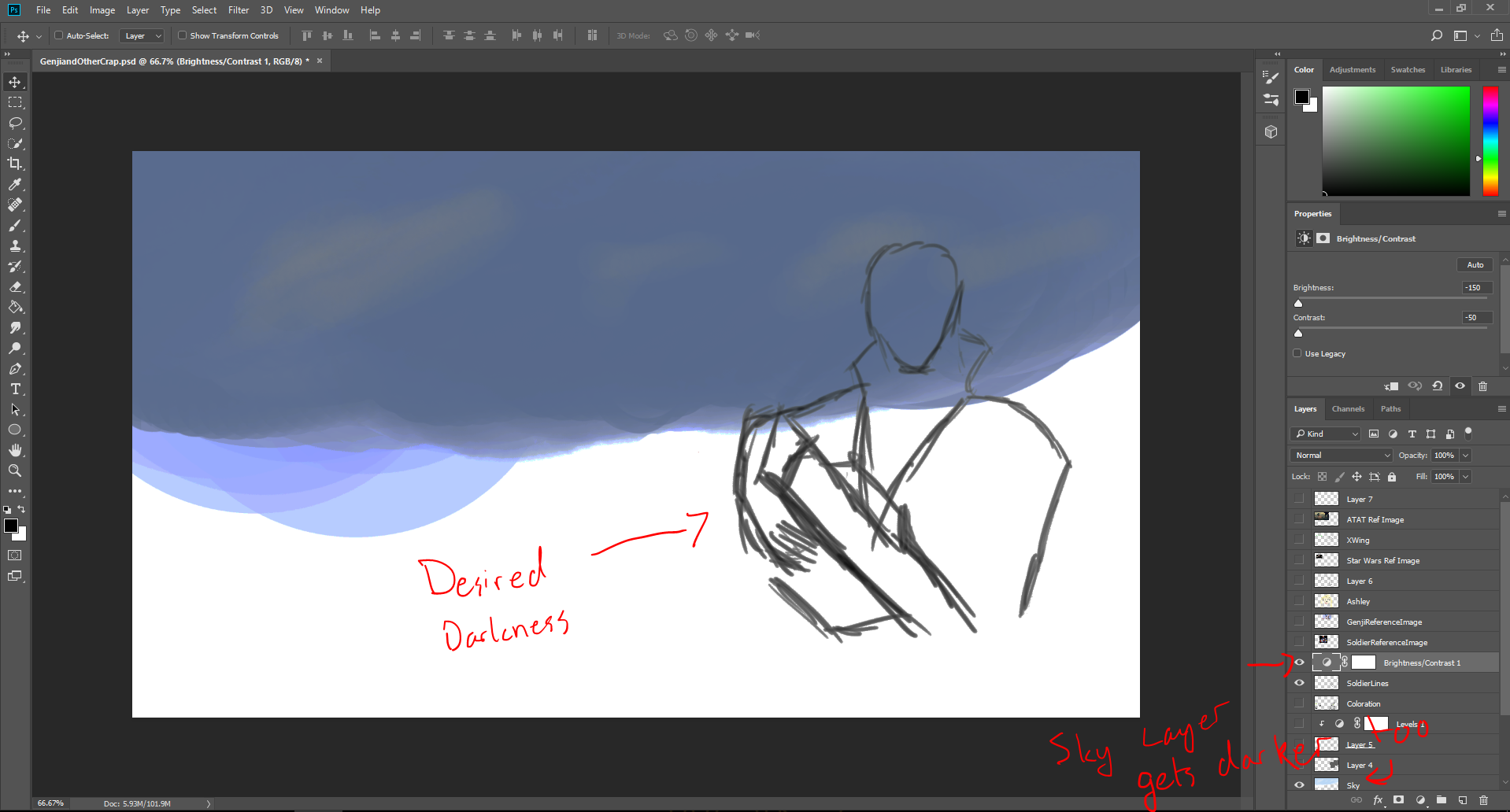

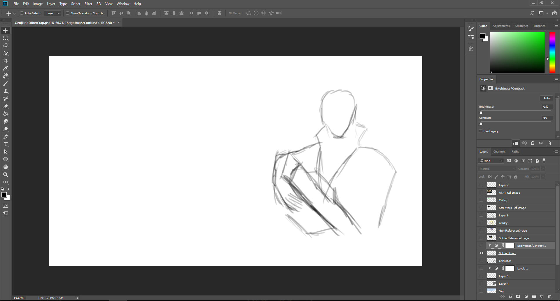

Dec 27, 2017 Dec 27, 2017
Here, I'll attach three screenshots of the whole thing. The first is of the original sketch. The second is with the adjustment layer turned on, which darkened the lines to where I wanted them, but also darkened a sky painting underneath, which I do not want. The third is with the adjustment layer turned on, after Alt+LClicking in between the two layers so that it should only apply to the sketch. Both images levels returned to the original, and no layers are affected. Sorry, my handwriting with this Intuos is awful, but I tried to explain the problem in the images as well.
