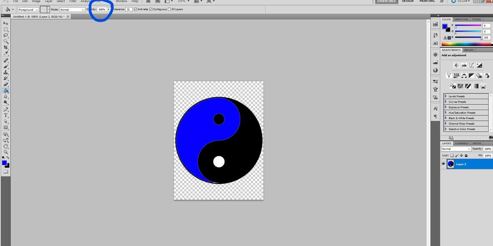

I know this is a 3 year old thread, but for anyone in the future here to fix this issue, like me:
MAKE SURE YOUR OPACITY IS 100%
I spent what felt like 30 minutes perusing settings and changing things when my color opacity was set to 11%, make sure this isn't the case for you!Screenshot_47_LI.jpg
