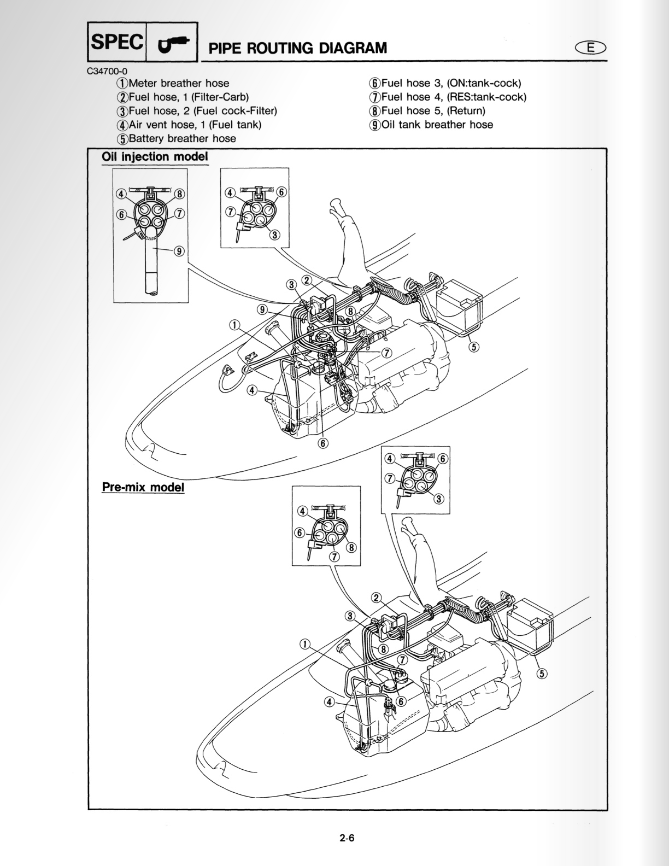

Can anyone give me any pointers on how to remove this shadow throughout this page so I am left with a white background containing text and the graphics?

    This is uneven lighting, and that's what you need to correct. You need an adjustment layer with a layer mask.
    Make a Curves or Levels layer that pulls the darkest part (upper left corner) up to full white. Then add a layer mask, press ctrl+I to invert the mask. The mask should now be fully black to hide the adjustment.
    Then use a soft brush to paint the adjustment in gradually, bringing the shadowed portions up to full white.

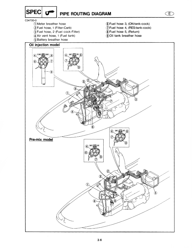

    And the final result:
    January 20, 2019
    Wow, that looks a lot better. I'll admit the layer mask confused me as I didn't see a lot of change with it. Is there anyway to automate this process for 150+ pages? Thank you again!
