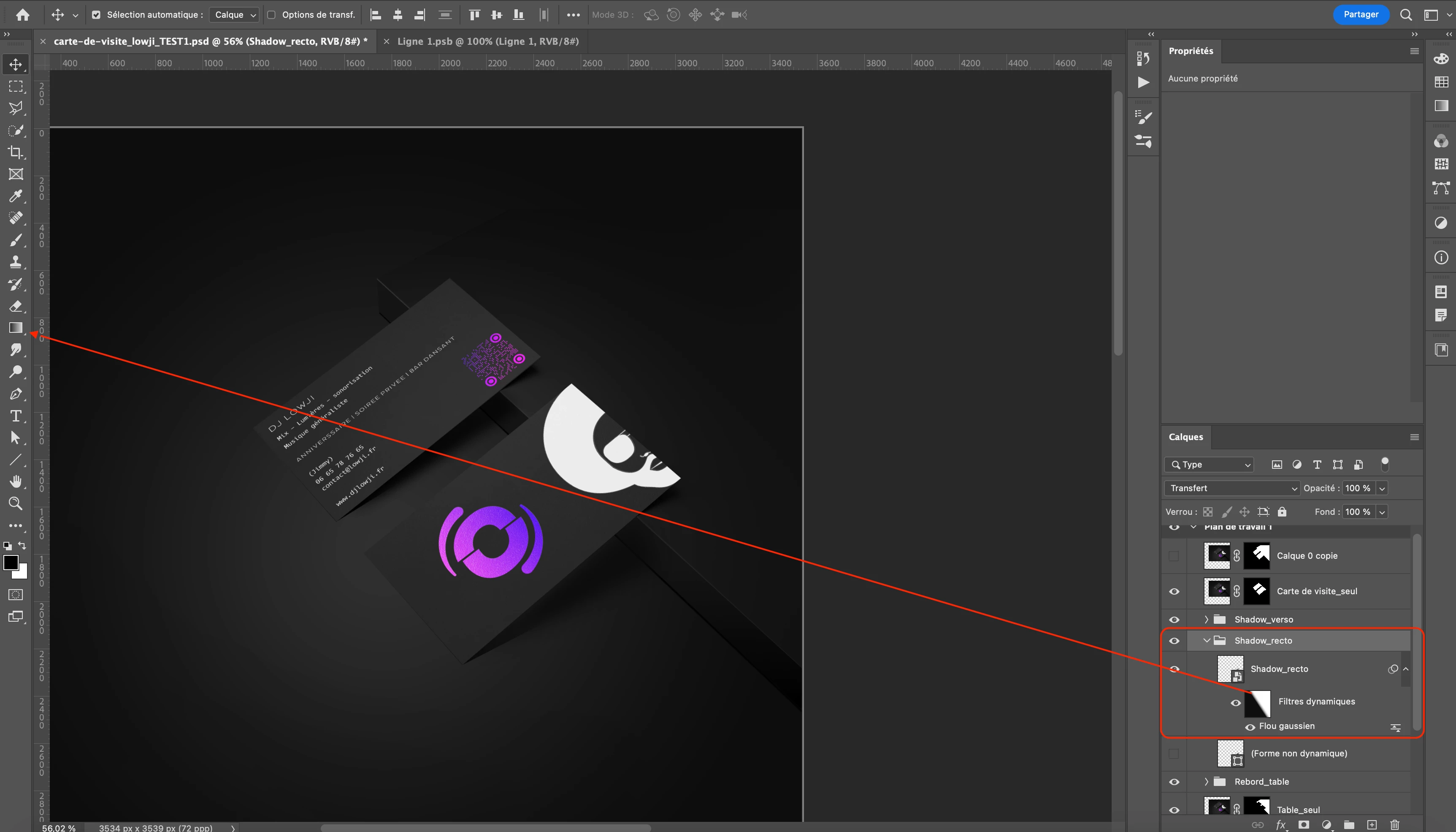

Correct answer davescm
The shadows should get softer the further away from the cards. So where the card and shadow touch the shadow is hard and at the other end very soft. A blur filter and graduated mask on the shadow layer should achieve that.

Thank you evrybody for your help !
Thank you Dave ! This is the answer ! 🙂
Then we can play by duplicate the layer. Et voilà
I post an image if it can help somebody.

You need to blur your shadow.

If I understand correctly, you just need to soften/feather the hard edge of the shadow you created?  How did you create the new shadow?  Perhaps a screenshot of screen with the layers panel would help.
