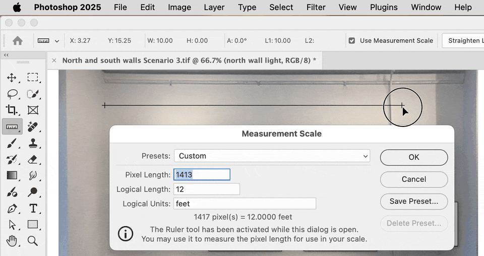

You don’t have to do much math if you use the command Image > Analysis > Set Measurement Scale > Custom to calibrate the Ruler tool to the known dimensions of that object in your photo like the sofa width. I did this to fit my mockup of specific frame sizes onto a photo of a wall at a site.
You mentioned that you’re using CS6. This feature might be available only in the CS6 Extended edition; because CS6 is now 13 years old I’m not exactly remembering if it’s in the standard edition.

Thankyou but im afraid im not skilled enough yet to actually understand what you mean.
Jul 25, 2025 Jul 25, 2025
When you use the Ruler tool with the Use Measurement Scale option enabled, the readout in the options bar isn’t reporting pixels, it’s reporting the real world measurement in the image, based on how you calibrated it in the Measurement Scale dialog box. So in the demo below, when you see W and L1 reporting 12, that’s 12 feet on the real wall, not 12 pixels in the document.

Going back to Conrad_C's first reply, you enter the physical size in the Logical Length and Logical Units fields. When that's done, the Ruler tool with Use Measurement Scale checked will read out the physical length.

Yes, the answer to your question should be completely answered by the info and the link in my previous replies. This is how it worked for me:
The site sent me photos of the room, and also they told me how tall and wide the wall was. They said the wall was 12 feet wide. This is like how you know how large the sofa is.
I opened Image > Analysis > Set Measurement Scale > Custom, and dragged the Ruler tool to fit the width of the wall, and I entered 12 feet. Now Photoshop knows that 1700 pixels long in the picture is equal to 12 feet in real life. With that done, the options bar shows measurements in feet so that after I add my objects, I can place and size them to scale.
In your case, you want to calibrate the Measurement Scale using the size of the sofa that you were given.
I recorded a more specific demo below, and I realize this is how I should have done the earlier one. So I’ll edit that earlier post with this demo so that it’s clearer for anyone who asks this in the future.

We already covered this in the earlier replies: If you are using Photoshop CS6 Extended, the tool I showed is available to you.
