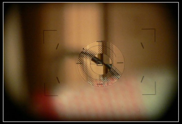

Hi.  I'm wondering if this is even possible...
I'd like to superimpose a split prism/split image focusing screen onto an existing photo (example is below).  Is there a way to manipulate a photo so that it replicates this technique?  Thanks!

Does this help?  Shout if you have any questions.  The percentages are all layer opacity.

From memory:
I copied the background layer and shifted it sideways.
Make the circular selection and added a layer mask
Blured the background and desuarated it a bit.
Ctrl click the layer mask to load the selection, and stroke the selection 1 pixel with black.
Copy the stroked circle layer and maske it smaller with Free Transform (Ctrl T)
That made the smaller circle less dense, so I reduced opacity of the larger circle to match it.
One pixel fully hard brush stroke through the circle.
Added the triangles and copied the layer mask to the triangles layer (Alt drag.  I usually have to do this twice to keep the layer mask on both layers.
A wee tip:
When blurring one side or the other of a selection, using the usual blur tools will let the other side of the selection bleed into the blur.  The upper image bluured the background with Gausian Blur 20 pixels.  You can see red from the shirts bleeding into the blurred background.  The lower imaged used Field blur (any of the lens blur options will work) and there is no bleed making for a much cleaner result.
