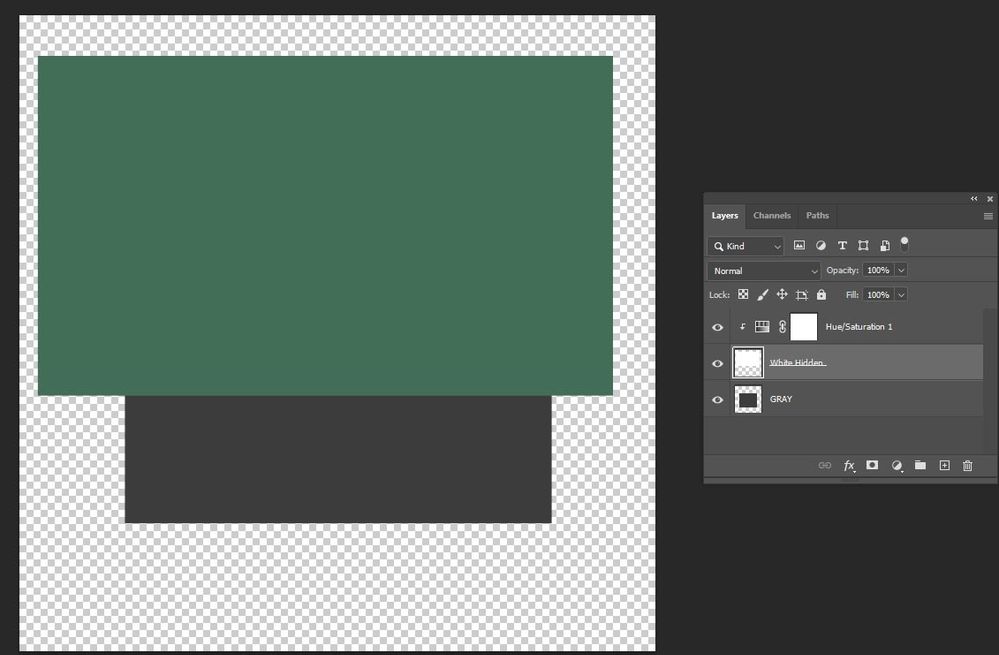

When exporting a PNG from a PSD, the hidden layers become active, changing the result.
I created a simple file with a gray rectangle.
Then a white rectangle with a Hue Saturation adjustment on it, turning it green.
If I hide the white rectangle with its adjustment hidden automatically, the PNG result activates the adjustment layer, turning the gray rectangle green.
It should preserve the result of visible layers.
Windows 11 version 23H2 build 22631.3296
Photoshop 25.6.0
gray-png-test-PSD-Layers-hidden.jpggray-png-test-PSD-Layers.jpggray-png-test-Result-Fail.jpg

How are you saving the png in Photoshop 2024?
Explorer ,
Apr 10, 2024 Apr 10, 2024
File / Export / Quick Export as PNG-8

@PeterPetersen try using Save As to PNG.
Explorer ,
It worked, but I can't use it because results in a larger file size with 32bit.

I'm able to replicate the issue with Photoshop 2024 (ps ver 25.6) on both Windows 10 and macOS Sonoma 14.4.1
when Use legacy "Export As" is enabled under Edit>Preferences>Export>Options.
Is there a particular reason you need to have Use legacy "Export As" enabled?
Explorer ,
The edges of the new system becomes worse than the legacy export.
And the file size is bigger on the New Export.
