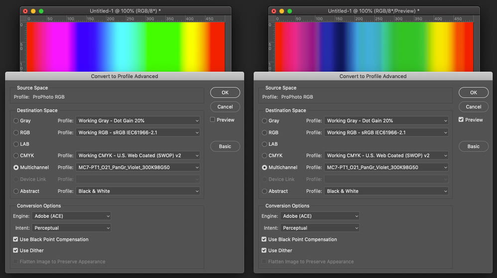

You can create a multi-channel ICC profile with the appropriate ICC profiling software and Photoshop can separate to such a profile using the "Advanced" Convert to Profile option:
This is not something that really works well using "generic" profiles, best results would be for the printer to do a press run using supplied 7 colour profiling targets, then you would measure in the charts and create the profile. If you don't have the software, hardware or knowledge to do this, then I would recommend hiring a consultant to do this for you, so add that to the budget.

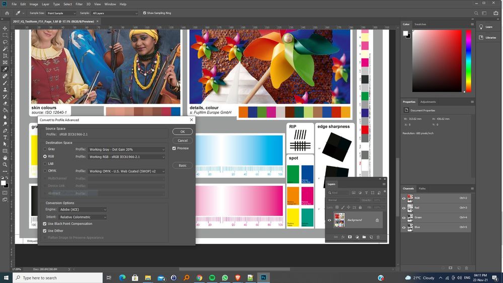

I tried to follow your advice but the multichannel option is disabled. How can I activate it?

Could you please post a screenshot with the pertinent Panels (Toolbar, Layers, Channels, Options Bar, …) visible?

This is the required screenshot.

Did you »create a multi-channel ICC profile with the appropriate ICC profiling software«?
Or have you gotten one from the print provider?

I tried a profile SC-P9000_P7000_Series_LLK LegacyBaryta_PK_v1 for Epson P9000 that has additional colors, orange and green.
The printer does, the profile doesn't; its RGB. That's all you can feed to an Epson like that. RGB to print driver, print driver then allows printer to use those additional inks.

Thanks, I will look for a real multichannel profile. Can you suggest where can I find such a profile?
Find one specifically for what and whose output device? Do you understand that a profile defines a specific device behavior?

And I would add, a specific combination of device, inks and paper...
By @avis42897919
This sounds like an Epson device profile, not a multi-channel analogue press profile designed to create separations.
By @avis42897919
You need to have a multi-channel ICC profile installed and then Convert to Profile - Advanced mode will offer that option.
