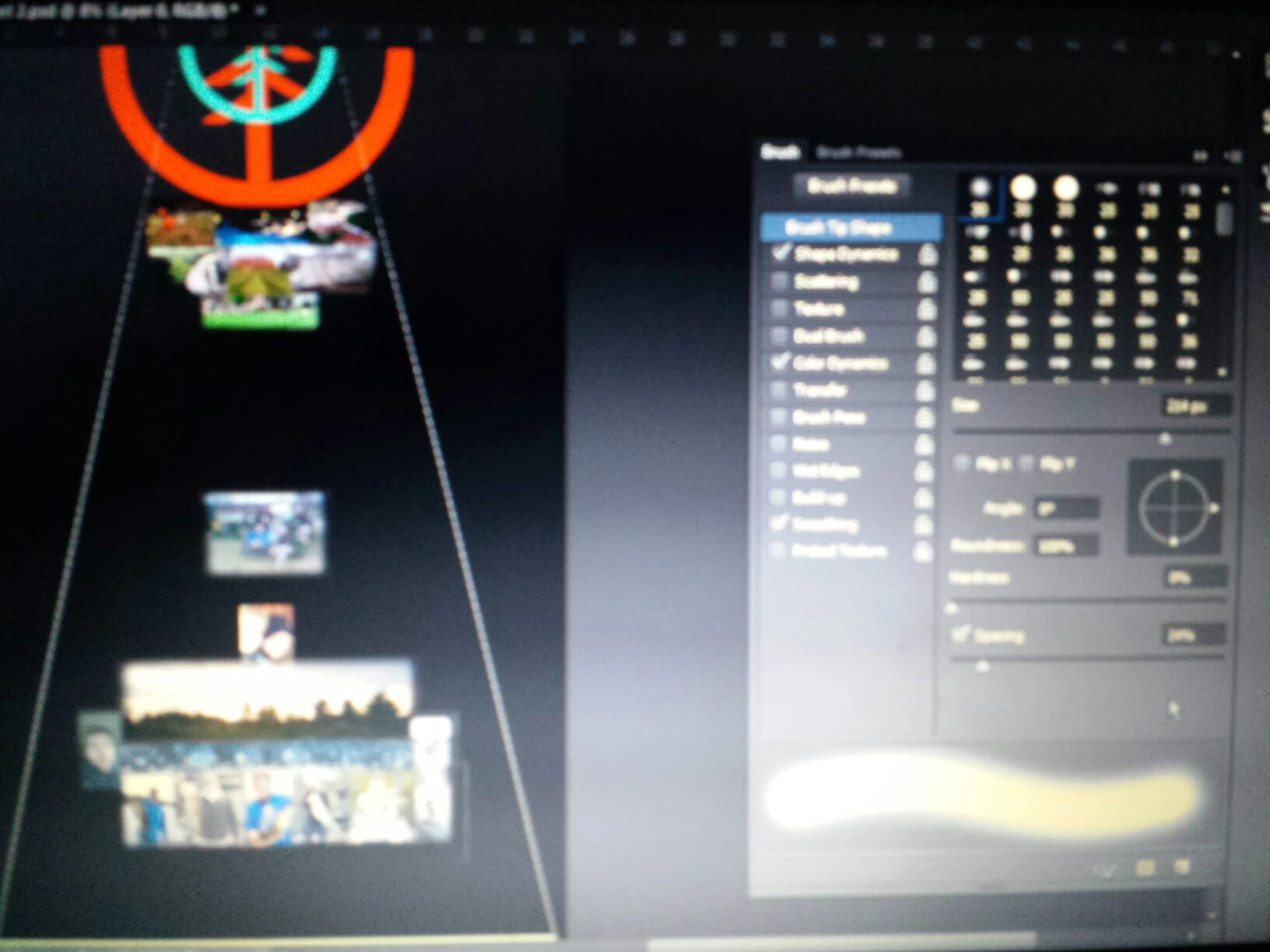

i know the pencil tool can draw a straight line with anchor points. is there a setting for the pencil tool that can mimic a 30 point brush, low hardness (faded side to side) at about an 80 degree angle or is there a way to make a straight line with the brush tool using a mouse?
i know this image is a bit blurry. what i want to do is replace the 2 white angled lines with the 30 point brush effect 230 pixels wide. the project on the left of the pic is a 2ft by 4ft canvas. any ideas? please help.

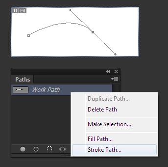

Straight lines are simple: using the brush click where you want the line to start (you will paint a single spot) then hold down the shift key and click where you want the line to end; Photoshop will draw a straight line between your start and end points.
Additionally, for even more control, you can use the pen tool to create a path, then just stroke the path with the brush.

1. If its vertical or horizontal lines, hold the shift use brush.
2. For Diagonal line use pen tool for path-hing and use stroke path as mentioned below

Thank you. I will try the brush click, shift, click method. It sounds quicker than what I found after playing around some more. Drawing a wide line (50 pxls) then applying a blur worked but took a while to update the layer after applying the blur. I guess there is more than one way to fillet the fish huh.
