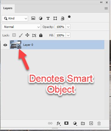

Hi when you convert to a smart object you should see this.

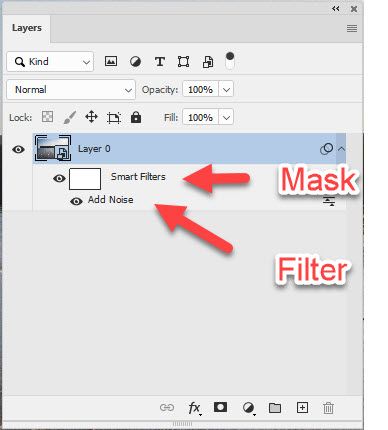

When you then apply a filter you should see this:

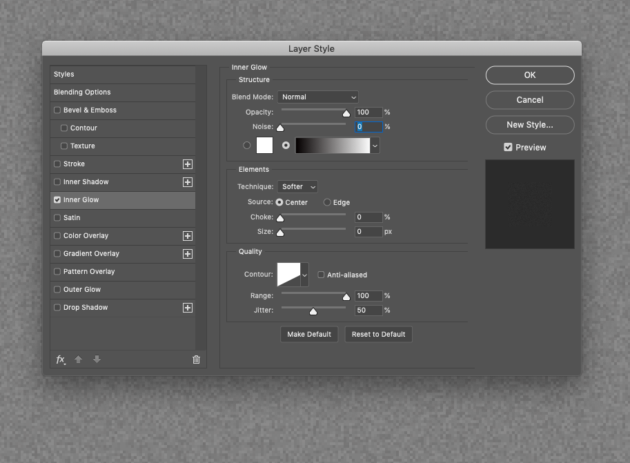

However how do I alter the noise, I cannot get that panel as you show, to appear, (normaly there is an icon for the effect and a double click reveals the panel for it) Normally in actions the action for that adjustment when double clicked will reveal the panel the action uses but not this time, despite double clicking the apodaca action. (what is apodaca anyway ?)
I need 0.7 gaussian with mono unticked. I must be able to apply that filter as if I was doing i normaly, if via a larger panel it can be replicated exactly I dont mind.  I need noise 0.7 gaussian mono off  applied to a layer with it to have the normal effect it would have if applied in the normal manner. I dont understand why the smart noise adjustment layer is overlay and 50% and grey. what 2:1 is etc.
after months of experimenting I found I needed 0.7 gaussian applied to my colours, so it must be doing exactly what that does in the normal way else months of colour matching will not work.
I need to know step by step how you did this, I would create it step by ste, having an action sees it done without me knowing what each step required. I see a video on youtube of creating a layer and choosing overlay as it disregards 50% grey and he uses blur gallery>field blur that has a noise tab and it gives noise size and far better options. I try this in CS6 and there is no noise tab.
Its an adjustment layer with noise though which is what I need, now to ensure its set to the exact same things that noise 0.7 gaussian yes and mono no does.
Merlin
Feb 27, 2020 Feb 27, 2020
You edit the adjustment layer created by the action to alter the noise settings, not the action (double click the effects/inner glow under the main adjustment layer). As this noise is not using the noise filter, the settings are different.
You will need to come up with your own settings and opacity in order to come close to the desired filter settings (try adjusting the Apodaca adjustment layer opacity to say 8%).

<<You edit the adjustment layer created by the action to alter the noise settings, not the action  and to double click the effects/inner glow under the main adjustment layer.>>
Your action creates a new layer with a grey box icon, layer name is Smart Noise, far right are two small overlapping translucent squares icon.
Firstly it has applied noise to ALL my layers, so right click and select the masking option, solves that.
Normally an adjustment layer that I use has a small downward pointing arrow (denoting its been related to the layer directly below, then a symbol such as set of scales for colour balance, then an upward orientated chain link then a white square. Click the scales and the palette open for colour balance.
On yours, nothing there of any of those.
I click the overlapping two squares, nothing happens, I double click it and ‘layer Styles’ appears, with no styles ticked.
I double click ‘inner glow’ though one click is sufficient, it shows noise as 0, yet I am seeing noise, so that can’t be it. And anyway there is no Gaussian or mono options there.
Just where are these settings to be found ? I look at the other styles offered, none have noise let alone noise with Gaussian and other options the noise filter gives.
<<As this noise is not using the noise filter, the settings are different. You will need to come up with your own settings and opacity in order to come close to the desired filter settings (try adjusting the Apodaca adjustment layer opacity to say 8%).>>
Worried as I need to match the effect of 0.7 gaussian and mono off, if I have also an opacity to fiddle with and no known settings to match that of noise 0.7 gaussian and mono off, it will take forever to match the effect.
Maybe opacity 50% might be a good start as discovered, but I would need to try a test if I could get at the noise and Gaussian settings etc.
