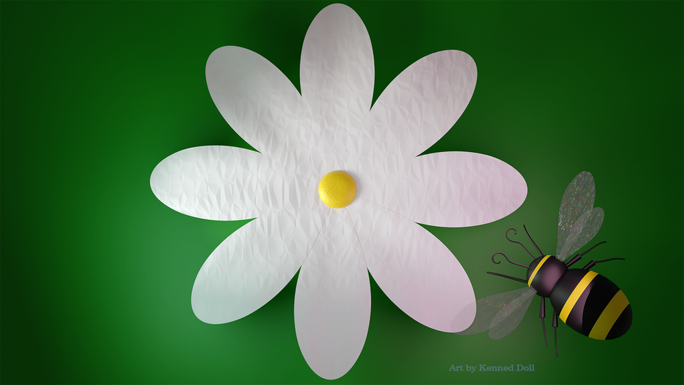

I've been learning about curves, hue/saturation adjustment black/white adjustment, camera raw, etc. But, mostly things are based on identifying colors. How can one target a brownish area?
I have an image that is 3d models. The ground is mostly greenish, but there is an area appears brownish because of light. How can I adjust that area?
In the image, the area under the bee's left wings appear blurred to me, because of a brownish tint. I would like to deemphasize that.

The vignette effect (dark edges) would need to be counterbalanced with an equal and opposite light value.
There are many ways to do this.
You could start with a Curves Adjustment Layer to boost overall highlights.  And then selectively remove highlights with a layer mask and round soft brush set at 40% opacity value.
In this example, painting with white brush conceals the adjustment layer below and black reveals it.

You can try using the dodge tool.

Thanks. Or, burn tool I guess.
I started removing the bee and flower and using stamp tool and smudge. I might try that again with burn tool.

Sometimes with areas that are off, particularly with faces that have areas that are off color, I use color range. I zoom into the pixel level, set the eyedropper to sample a single pixel, then select a range of pixels that are way off. Then I use curves to correct the color.

Thanks. That looks prommising!
