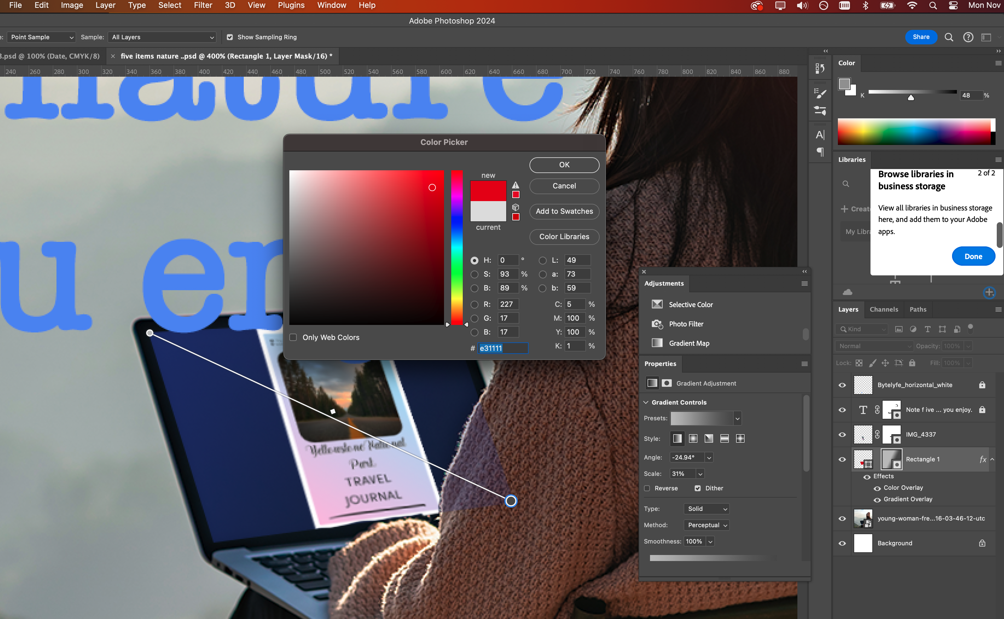

How do I add a color not shades of gray, but a colored gradient?
  • November 13, 2023
  • 1886 views
I've been working on this one problem for about three hours now there is literally nothing online that is helpful Orioles on YouTube nothing all I need to do is change the color of a gradient but it's only shades of gray no matter what color I pick I only get gray. In the photo, you can clearly see that I have the color red selected but it turns gray.

A couple of things working against you -
1. You have a color overlay ontop of your gradient hiding the result. Remove it.
2. Your mask on that layer is very light/transparent and would not show the results clearly.

Instead of adding a Gradient to a Layer Mask, which can only be grayscale, double click on the Gradient Overlay layer effect to change the colors of the existing Gradient or add an additional Gradient Overlay.

Thanks, but that has even less effect doesn't even change the shade of gray as you can see in the picture here I tried what you suggested, and I clearly have a yellow color selected and this time there was no change whatsoever. Do you have any other ideas?
