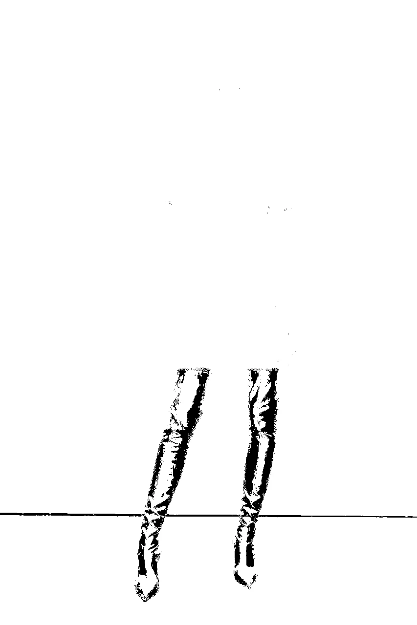

How do I automatically straighten the horizon in a photo?
Hello. Please help me solve the problem.
I have a lot of studio photos taken without a tripod, so the horizon is often tilted at different angles.
There is a clear contrast between the wall and the floor.
I need to automatically straighten the horizon in these photos, no change in perspective, no cropping. Just the angle of the slope.
Lightroom, camera raw are not up to the task.
The manual method, using a ruler, is not for me either.
Perhaps there is some Script that can help me solve my problem?
*Sample photo added.

Hi! Unfortunately, such scripts are not universal and it works well only for solving a specific problem.
Try this one. It works well on the image posted to you, but there may be issues with other images.
I've modified the script so that it tries to find an area in the bottom half of the frame with a big difference in brightness, assuming that's where the floor boundary is. For large images, you can increase the size of the BATCH_SIZE constant (this is the number of consecutive pixels within which the script tries to find the maximum brightness difference)

Jan 12, 2023 8:23 PM UTC
Well, you can't. Either something gets chopped off or there is distortion. You may be able to manually adjust and have transparent areas on the corners, that would require manual fill. Or you can manually use Perspective/Puppet Warp, those are powerful but can be tricky and slow.
Next time hold your camera straight and give plenty of room around the subject for cropping if needed.
Andrew Bold
Jan 12, 2023 8:38 PM UTC
I chose an unfortunate example (the picture with the girl). Don't take it as a rule.
99.9% of photos don't have cropped legs 🙂
In this case, you don't need to pay attention to it.
The transparent parts I can easily remove with action.
The main thing I'm interested in now is just to rotate the picture, without cropping, without deformation and distortion 😞

After that, to modify the script so that the script detects the black line and not the absolute difference in brightness "findFloor".
But due to my poor knowledge of scripting I was not able to get a working result.
I will be very grateful if you have an opportunity to help me

Andrew Bold
Jan 11, 2023 11:43 PM UTC

Andrew Bold
Jan 12, 2023 10:40 AM UTC
Hi. Thanks for the answers, but I wrote in the description that this method doesn't work for me.
I will explain why. There are several reasons:
  1. Straightening Camera Raw and Lightroom crops the image. I can't allow any part of the image to be lost, because often the legs will be cropped.
    2. Using this method, the picture is distorted, it changes the perspective. I need the picture to remain original and only change the angle of the picture.
I'm even fine with leaving transparent areas on the picture that appear when I tilt the image.
