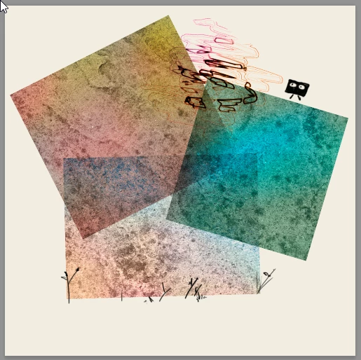

You could try something like below
Set the scanned layers (in my case I just used sections of a black & white image of a paving stone texture that I had handy) to blending mode multiply.
Clip a layer to each (Alt-Click on the border) and set that new layer to blending mode color. Then brush on color with a soft brush.
I have shown the blending modes in the layer names
Dave

Sorry to hound you Dave but any insight on the brush you're using? Even at 0% hardness and making the brush larger, the transition between colors is so drastic compared to your subtle one.
Thanks!
davescm
July 16, 2017
I have PM'd you a link to the file so you can have a closer look at each layer
Dave
