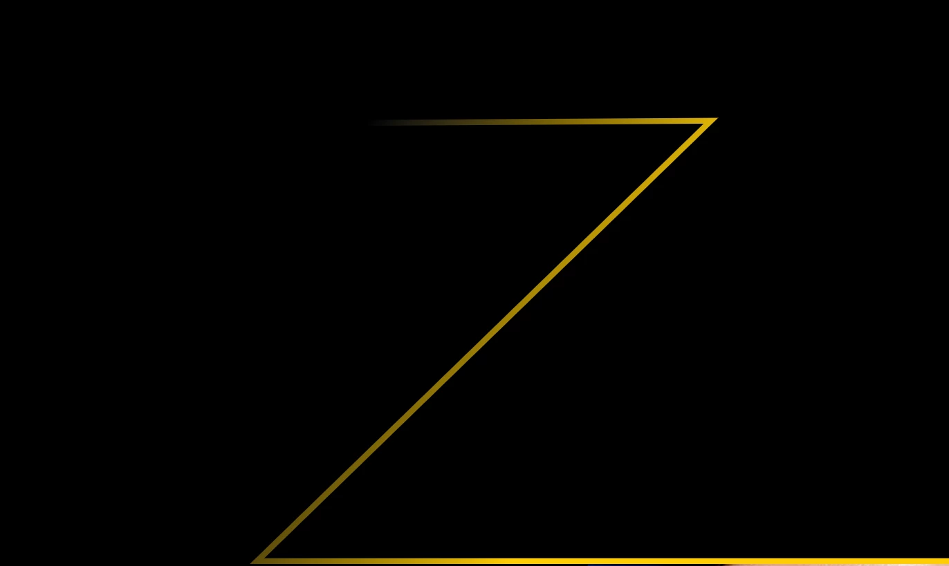

Hello you guys!!!
I would greatly appreciate it if someone wouldn't mind explaining to me how to create this "fade" type of effect that you can see applied to this solid yellow line.  Notice how the fade isn't sharp or sudden, it looks more elegant and gradual.  Thank you for your suggestions!!!!

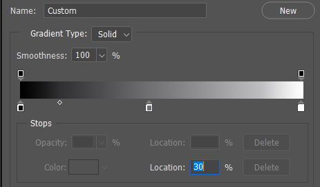

The only thing I would add is to use Foreground to Transparent when applying gradient to the mask so you can build the effect.  I'd also keep each part of thge line(s) on separate layers to maintain better control.
I'd also remind you that we don't have to use simple gradients in layer masks, and construct our own complex gradients
However!  If I was doing it I would still use brush settings because they aree one of my favourite things in Photoshop.  You'd have to overlapthe brush strokes so you could trim back to the sharp corners.  The upper stroke looks to be a very close match to the sample image just using opacity set to Fade with brush spacing set to 6%
Trevor.Dennis
June 24, 2021
Just out of interest, I thought I'd compare a simple foregroud to background gradient (the lower gradient) to the custom black-grey-white gradient I mocked up.
