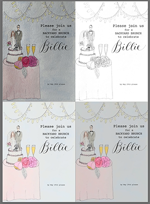

You may consider choosing the K channel of the CMYK set, copying it, changing the mode to Lab Color and replacing the Lightness channel with the K channel information.
Some very subtle texture generated in the a and b Lab channels still appears in the the image. so choose each of those two and apply Filter > Surface Blur : Redius 39 Threshold 33.
Tbe two bottom images show the darkening of the higlight end of the scale using Curves on the new Lighness channel.
Convert to RGB
At this point, you may alter the color locally: the flowers, adjacent object and wedding dress, for example

Thank you! I will try this so I learn something new. I don't know if this would work for this particular project as I am sending them to be printed but I'm eager to learn as much as I can about PS so I'm eager to play. Thanks so much!
