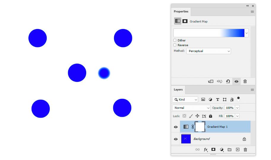

Apr 24, 2023 Apr 24, 2023
A gradient map adjustment layer might do what you want. It maps luminosity values to a colour gradient so selecting the colours you want to map to should achieve that change.

Apr 25, 2023 Apr 25, 2023
The gradient map adjustment layer looks like this, you can see the original on the bottom layer and the gradient I used in Properties. Double click the gradient to adjust it :
Dave
No need to convert to B&W or invert. A single Gradient Map adjustment layer will do all the adjustments you need (see screenshot above which shows white on blue converted to blue on white in one step)
