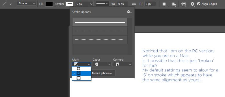

But the Stroke Color is apparently set to white.
Your options bar show you have set a white stroke. On a white background you are not going to see much 🙂

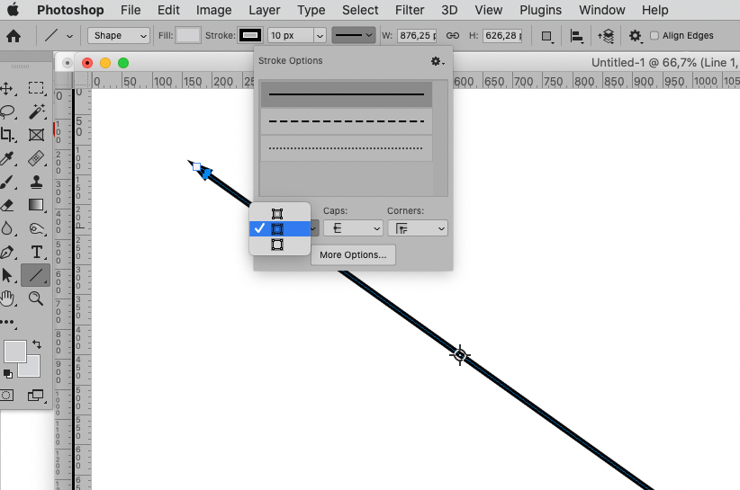

It easy to see your arrow heads pointing past the end of the line. Photoshop 2020 line tool works correctly,

Arrowheads still work in Photoshop 2021 … in a way.

The stroke needs to be set, as the line and line portion of the arrow no longer have a fill all done with the stroke.

Chuck clearly the stroke extends the arrowheads past the target pixel you point to. If you do not stroke the arrowheads are fine in the shape layer but there is no line. If you stroke outside the line is double width and the arrow heads are farther off target. If you stroke inside the Arrow heads are on target but the is no line. Line weight above 0 is required for a line tool to work. With line weight you do not even need to create shape layers and you can change the color of lines you as you draw without requiring additional layers. Adobe clearly made a blunder changing the line tool or they trying to make user require additional Adobe applications.

You need to set a Stroke (that is not aligned »Inside«, but »Center« or »Outside«).
Copy link to clipboard
Copied
