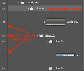

This is great, but how do I get it to turn on layers within nested groups?Screen Shot 2022-04-22 at 12.05.09 PM.png

@seanwickett
The code would need to be changed to loop into nested layer sets, easier said than done (for me). I'll see if I can find some code to hack, however, one of the other scripting regulars could probably do this faster and with less code!
Edit: To turn visibility on for everything, Select > All Layers and then use CMD/CTRL , (comma) for Layer > Show layers/Hide Layers toggle.
Or you can use the script posted earlier from Joonas to ony select all content under the single selected layer group, then toggle the show/hide layers.
