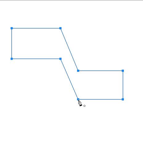

On the closed paths see the example below :
With the direct selection tool (white arrow), click on the segment you want to delete...
...and press the delete key:
Same again for the other closed path. Click on the segment you want to delete...
Press delete
Then with the pen tool click on an anchor point to pick up the path....
and click on the other point to join them
Same again for the other path points to make a new closed path

With the joining, I meant once having deleted the path from the end of the first and second rectangles, and thanks for showing how that is done,  move them together so the nodes intersect (i.e. are perfectly aligned with each other, forming a new larger rectangle, how does one joint the two halves together. if this was CAD one would select both shapes and go join and it would say two paths joined as one closed curve.
The article doesnt mention how to have two paths dragged together so the ends touch and joining them, unless I missed reading that somewhere.

I have two rectangles, each missing one side, such that when I bring them TOGETHER, SO THEY TOUCH ON THE ENDS, that is the shape I need.
e.g I trace the top left and bottom of the left page of a book, I then trace the top right side and bottom of the right page of the same book, I bring the two traces together , I dont want to go adding extra to the pages by having them near each other and click forming a line between them, so adding lets say an inch more at book middle,  they join at the book centre seam, but how do I get them to join to become a closed path ? just like you might bring your left finger tips together to touch the right finger tips., and use superglue to join them together !
Not sure what all the coding was for, I am not into coding or drawing with such.
Actual job was a cross with an ornate end to each arm , all 4 the same, draw the first arm, copy paste it rotate 90deg and again and again, I have four arms, bring them together and need to 'superglue' the ends together  to get a closed path cross with its 4 ornate ends.
The pen tool is there to be used, and it did the job well, just need to fuse/weld/superglue the four paths together.

Feb 20, 2020 Feb 20, 2020
Bring the two (or more) path elements together, select them with the path selection tool (black arrow)  and use "Merge shape components" from the drop down in the option bar
