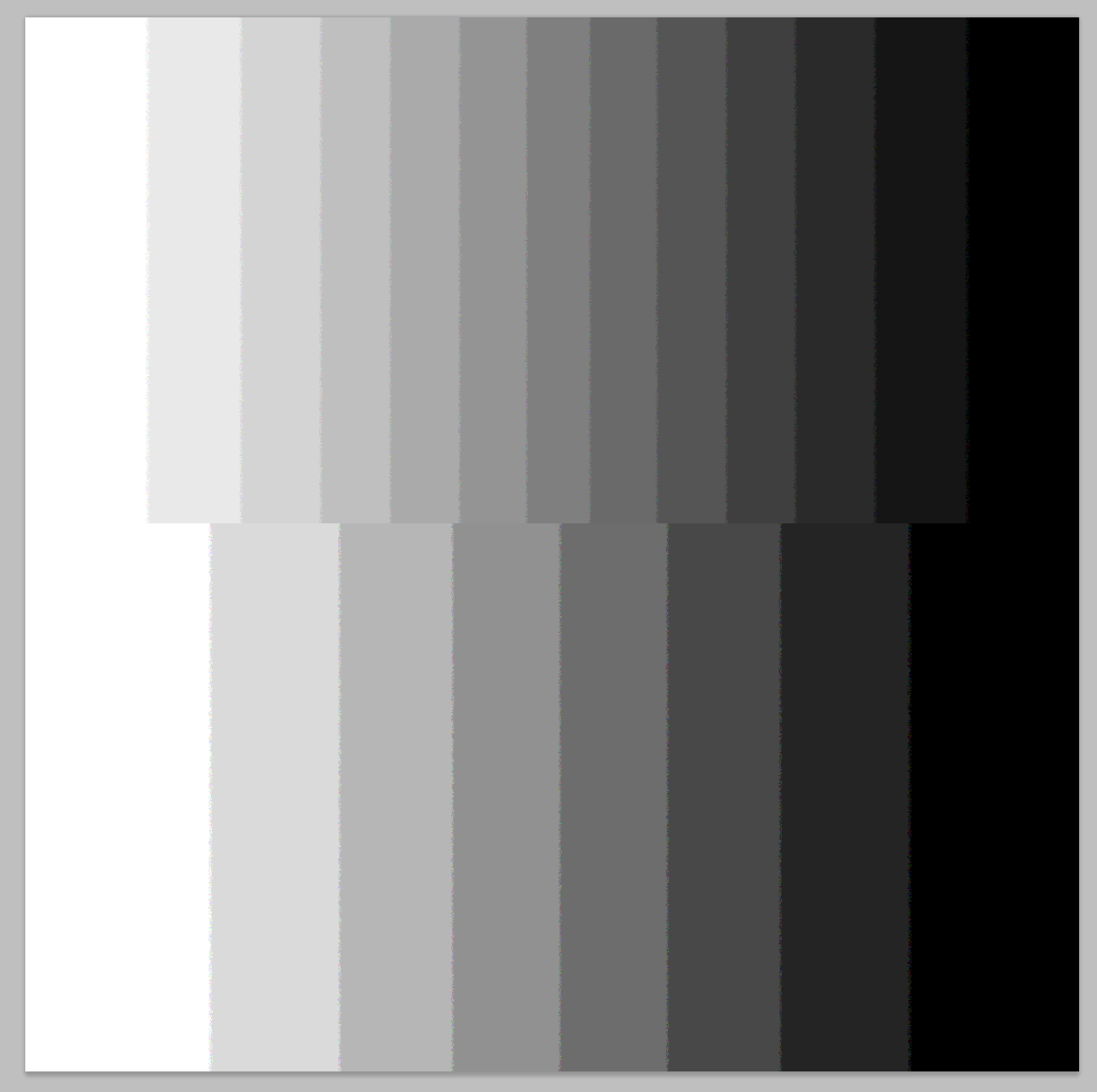

It's not really more colors as it's a different parameter or range of colors you get in that particular gamut.
For example, in the graphic below. Both ranges go from white on the left to black on the right. But the amount of ways that range is cut up into other shades is how bit depth is used to create a range of values between those colors.
