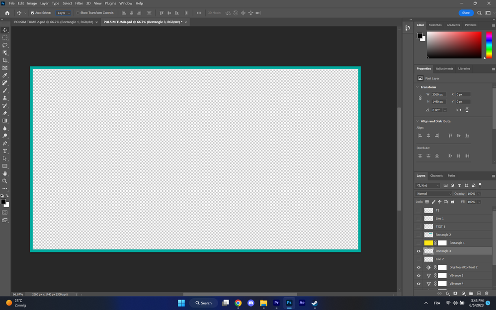

Can someone help please?
I created a frame and I would like to add rounded corners to it so that it will fit perfectly inside youtubes new rounded thumbnails.
Usually there is an option at properties to add rounded corners to a rectangle but for some reason there isn't and I don't know how to do it.

The reason you don’t see rounded corner options is that for the layer selected in your screen shot, the Properties panel says Pixel Layer. Rounded corner options are available only for vector shape layers and paths. Draw it with the Rectangle tool in Shape mode and you will get rounded corner controls in the Properties panel, along with Fill and Stroke controls.

June 5, 2023
When I create the shape, I have the option to round the corners but in order to create a frame I add a mask and remove the middle part of the shape. As soon as I do that, the option disappears.

@stan5D3E
When the option disappears, Photoshop is letting you know that you've converted the Shape Layer to a Pixel Layer and no longer have Shape options.
