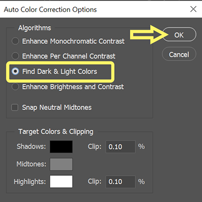

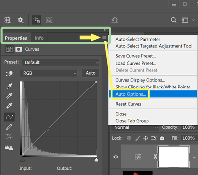

Photoshop Curves Adjustment - Automatic Option
  1. Add a Curves adjustment layer.
  2. Click on right hamburger menu of the Properties tab (see screenshot).
  3. Select Auto Options.
  4. Select the “Find Light & Dark Colors” option. Click Ok.

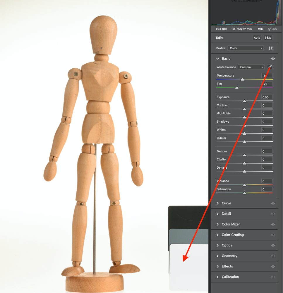

TheDigitalDog
May 29, 2023
Couple of ways to do this.
You might want to use Adobe Camera Raw as a filter, WB using its WB tool (eyedropper) on the white patch. Even if you get a neutral from that patch, you may still want to adjust to taste, using the Tint/Temp sliders.
Author “Color Management for Photographers" & "Photoshop CC Color Management/pluralsight"
