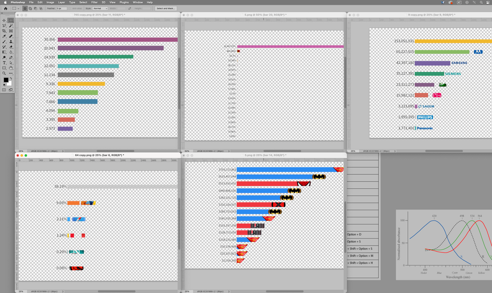

I receive about 1000 chart images daily that following images are two sample of my images:
Now i want to align values of charts using flip horizontal and use photoshop action or script to apply on 1000 daily images like following:
The left side of the chart bars does not need any changes and photoshop action can divide the images into two parts (left side of chart bars - other sides of chart bars)
next step of action after dividing images, the values on the right side of the chart bars should be selected with Color Range (dark color)
Now i have problem after above step. I must expand selection of values (that i selected by color range) to only left side and selections must extend to the edge of the left border of the layer.
After extending the selections to the leftmost point of the layer, i can convert each selection to specific layer and every layer can filp horizontal.
Finally with above steps photoshop action can align all of my images values.

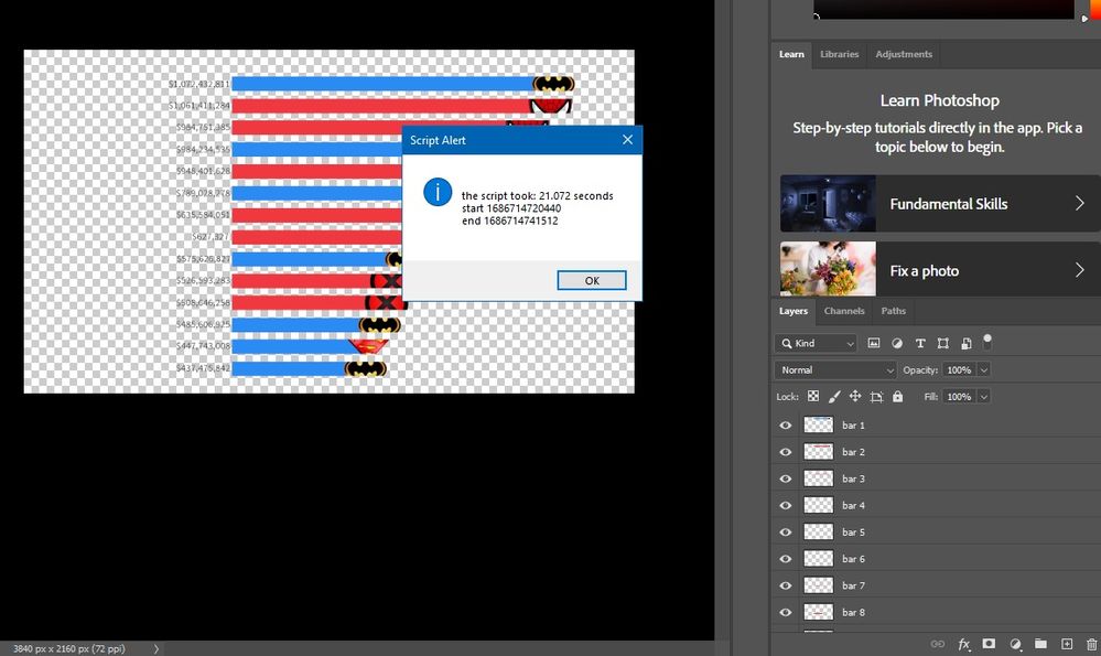

Community Expert , Jun 16, 2023 Jun 16, 2023
This should perform at least somewhat faster if you want to give it a try:
// moveNumbersLeftOfBarGraphs
// separate elements in specific graphics, put the bars right and align the numbers on the left;
// ideally bars and logos should be colorful to make numbers better identifyable;
// 2023, use it at your own risk;
executeAction( stringIDToTypeID( "revert" ), undefined, DialogModes.NO );
var time1 = Number(timeString());
moveNumbersLeftOfBarGraphs ();
var time2 = Number(timeString());
alert("\

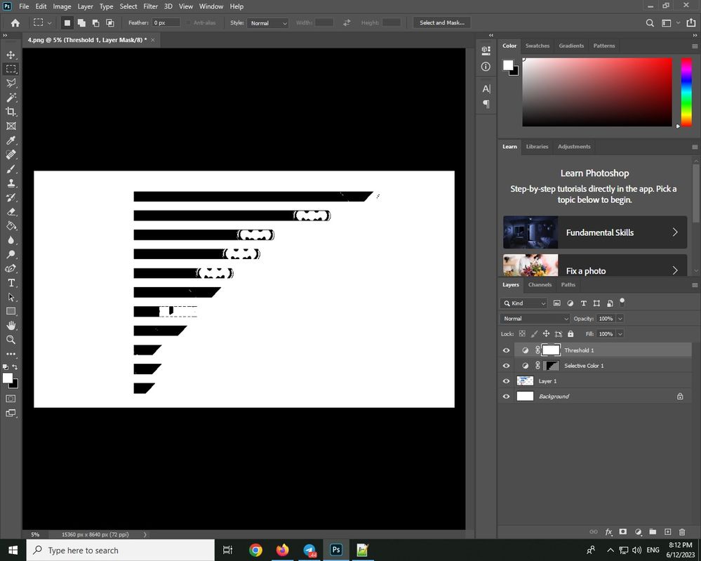

My problem is not Magic Wand Tool. I used Magic Wand Tool to show you what is my method. after split all bars to seprate layers and remove main layer (layer 1), I must use color range to select right white areas but after theme i can't use delete key to remove white areas from splited layers (i must select each layer and use delete key). i need a way to remove by one key or click.
note that i can add splited layers to a group and add mask to group and then remove white areas but after remove i can't disband group for flip splited layers. Maybe I need a script that flip horizontal all layers inside a group without disband group.
alert("\nthe script took: "+((time2-time1)/1000)+" seconds\nstart "+time1+"\nend "+time2+"\n\n");

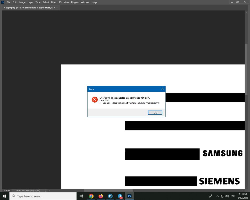

what is this error? i tried to run your latest reply script on some samples but i get this error
Jun 11, 2023 Jun 11, 2023
If at this point it is still not obvious to you that you need to provide affected file/s for testing this seems pointless.

idk, this time even i installed latest version of photoshop (24.5) and tried your script and get following error!
Jun 12, 2023 Jun 12, 2023
Your claim is meaningless unless you provide the files on which the problems happen – both the image/s and the jsx-file you are using.
Engaged ,
quote
By @c.pfaffenbichler
i mentioned above jsx file but i can't provide images because i get this error on all of sample image files

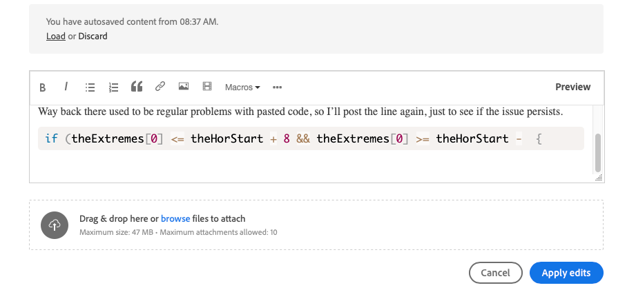

What the …?
The line has be truncated in my last post AGAIN!
Please correct it manually:

Line 68 is damaged, correct it to
if (theExtremes[0] <= theHorStart + 8 && theExtremes[0] >= theHorStart -  {
No idea how the error was introduced, copy/pasting code should normally not remove parts …
Edit: And just to be clear: The line was damaged in my post, so it was not your copy/pasting where the error was introduced.

I sent you a link to a jsx-file that works here.
Way back there used to be regular problems with pasted code, so I’ll post the line again, just to see if the issue persists.
Edit: test 2
Edit: test 3
Apparently the code gets truncated when I edit the message.
Screenshot 2023-06-12 at 17.37.56.pngOnce editing commences: Screenshot 2023-06-12 at 17.38.06.png

I downloaded jsx file from your link and renamed it and then tried again but i get following error again!!!!
The Script works fine on the file »4 copy.png« you sent previously, so in the absence of a new file (or at least meaningful screenshots) I have nothing more to add.

your script everytime stuck at following step and show me that error.

tnq very much. i modified your script with following code and your script worked successfly:
////// get histogram //////
function histogram () {
////// select the composite channel as the active channel. the current one can be a mask.
var d = new ActionDescriptor();
var r = new ActionReference();
r.putEnumerated(stringIDToTypeID("channel"), stringIDToTypeID("channel"), stringIDToTypeID("RGB"));
d.putReference(stringIDToTypeID("null"), r);
d.putBoolean(stringIDToTypeID("makeVisible"), false);
executeAction(stringIDToTypeID("select"), d, DialogModes.NO);
var ref = new ActionReference();
ref.putProperty (stringIDToTypeID ("property"), stringIDToTypeID ("histogram"));
ref.putEnumerated( charIDToTypeID("Dcmn"), charIDToTypeID("Ordn"), charIDToTypeID("Trgt") );
var docDesc = executeActionGet(ref);
var list = docDesc.getList(stringIDToTypeID("histogram"));
var theArray = new Array;
var theTotal = 0;
for (var i = 0; i < list.count; i++) {
var d = list.getInteger(i);
theArray.push(d);
theTotal = theTotal+d;
return [theArray, theTotal];
  Your script works great, but the speed is very slow. for example in one of images it take 21 second time!
if i want to run your script on 900 files then it take about 1.5 to 2.5 hour!
can i run script faster?
Jun 13, 2023 Jun 13, 2023
Good detective-work!
On my computer I turned off the automatic creation of Layer Masks for Adjustment Layers (via the Adjustment Panel’s pop-up-enu) so the Threshold Layer has no Layer Mask and the Composite Channel stays selected – that’s what makes the difference apparently.
On my computer it usually takes about 5 to 6 seconds for the images I tested, but that is not ideal for that volume of images, either.
There is certainly room for improvement in the Script but at current I don’t have the time to look into it.
