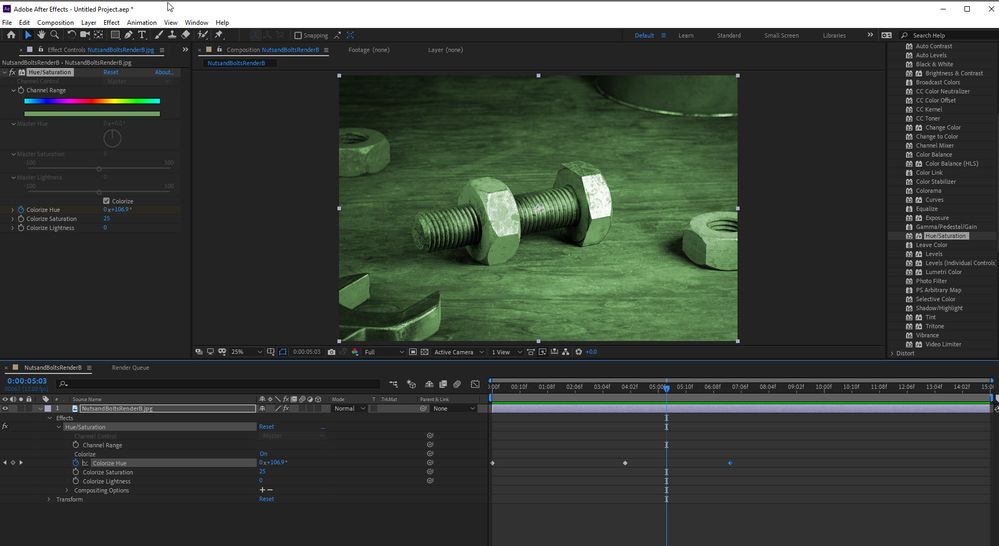

Hi
Do you have to use Photoshop? I would do that in After Effects where you can keyframe the adjustments. You could then Export to an image sequence or directly to a video format
