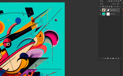

Apr 13, 2023 Apr 13, 2023
I used color range to select the background, turned it into a mask and have a white layer below. The mask needs some clean up but this took one second....

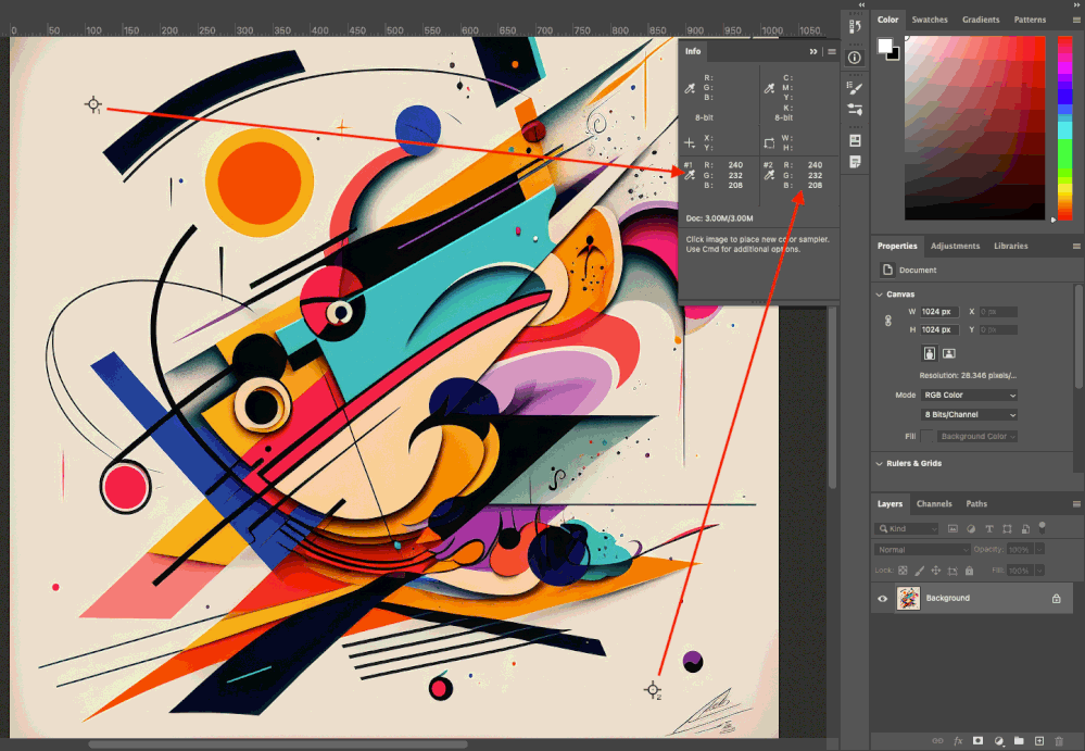

@The Instigator
Despite the simplistic appearance of the image, as you have found, it isn't a 1 click edit.
I would like to offer the following as another approach for you to explore.
I have set color sampler tool markers in the upper left and lower right and I am using the info panel to evaluate when white is achieved.
More work would be required, this is just a very fast start point which gets you 95% there in less than a minute.
Here is an animated screenshot GIF, it only uses two adjustment layers (selective color and levels):

I appreciate that you rarely use Photoshop.
The GIF animation is the step-by-step, there are only two steps and the values are highlighted in the adjustment layers properties panel. You can download and open up the GIF animation in Photoshop if it is looping too fast in each frame, or take a screenshot of each frame etc.
Search up how to add an adjustment layer if you don't know how.
As for the vignetting, you could simply add a new layer and paint white with a brush, or use the Dodge tool set to affect the highlights which may be better as it would help protect the signature on the lower right.
quote
Yeah, I'm not getting the information panels you show in the GIF. I see no way to add White as a color for an adjustment layer;
OK, there are many adjustment layers, but the one that I have shown is Selective Color as indicated in the screenshot along with the values for adjusting the whites in that particular adjustment layer type.
The Info panel is accessed under Window > Info (F8)
The Properties panel is under Window > Properties
Hopefully this will get you there, good luck!
