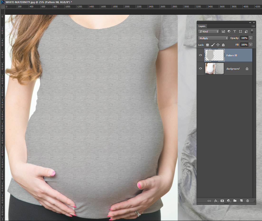

If you can do as you wrote select the white shirt like you wrote. You should not have any problem. Select an area of the gray teen shirt without wrinkles and shadows to define a decent seamless repetitive pattern,  Select the white shirt add an empty layer and fill the selection with the pattern you defined. Set the later blend mode to multiply and adjust layer use opacity, filters whatever hits you. Here a quick not perfect go at it. The hard or easy part is using the gray matter between your ears.

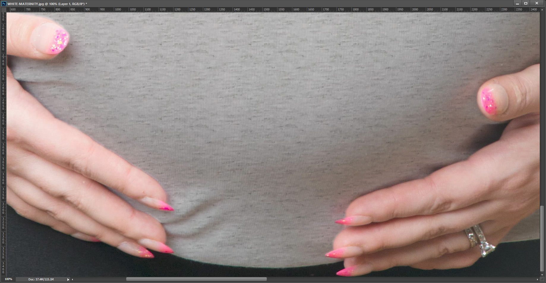

Thank you so much, I will take a picture of my gray shirt which I have here, hi should I take sample or pattern from gray shirt, should I create gradient?

After using Hue and Saturation on the White shirt as you had done,  I just duplicated the layer dragged the grey T shirt across, cloned out the folds and set blending mode to overlay

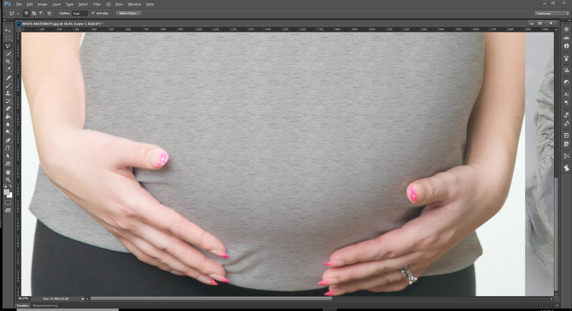

Thanks everyone, I kind got stuck here, once I select around white shirt with QUICK SELECTION TOOL, what do I do next to create mask, to apply gray t-shirt sample only to my selection. Thanks

One thing you can do is zoom in and add and remove area feather the selection use select and mask and adjust the mask. You can even add a layer mask on to the pattern filled layer to blend in the layer better.  Here is your full size image. You need to use that gray matter between your ears its more capable then your letting it be. It would be better if the pattern I made were better.

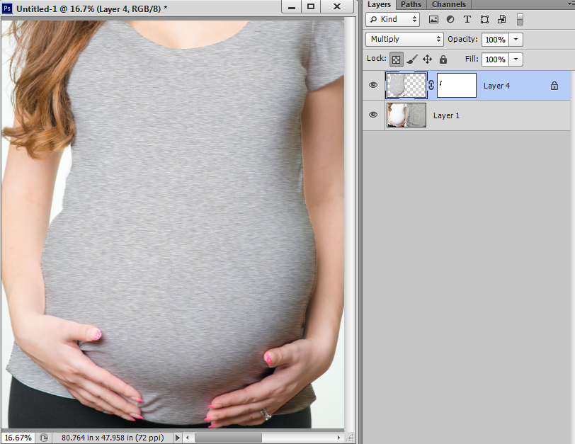

I only spent a couple minutes on this so it isn't perfect. Selected the Tee, put it on a new layer, mezzotint filter (fine dots) then motion blur.
