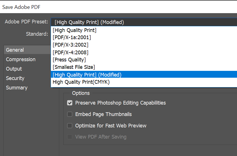

@Nizar Bredan,
When preparing images for professional print service, I SaveAs PDF at the recommended print Preset that my print professional tells me to use.  This is vitally important to ensure good results with the type of ink & materials they use.
May 13, 2023 May 13, 2023
If you crave high quality images for professional print purposes, use SaveAs instead of Export As.
ExportAs is for optimizing WEB images.  See screenshot.  Your goal on the web is to deliver maximium experience with the least amount of bandwidth.   The bigger the filesize, the longer it takes to load.
If you're using highest quality, that means the bandwidth is too high.  That's not good practice on the web.  Some web users have slow connections & highly restrictive data plans.  They won't much appreciate the longer wait time or busting their data allotment just to see an image.
Always be cordial to web users.  Their experience is what matters, not yours.  😉

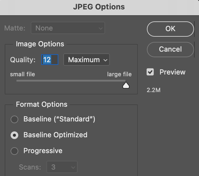

I think I can help you with this.
"Save for  Web" is the old school or Legacy way to prepare images for the Web. It will be going away in some future version and the new method "Export as..." and "Quick Export" will take over that role.
If you want the old behavior in Save As... for Jpegs, just go into Preferences > File Handling and set it up:
Then File > Save as... should allow you to choose the jpeg quality and preserve your print ppi. (usually 300) instead of defaulting to the standard 72 or 96 web ppi that Export sets up.
