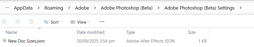

Sep 19, 2025 Sep 19, 2025
OK, I am not actually sure if we are supposed to keep those saved presets.
This is the file it saved to in Windows 11.  I had to close Photoshop for it to update (I am in New Zealand if that time and date looks wrong).  I might go to the effort of remaking my presets and saving that .json file, but I can't help but think there is a better way.  Anyone know it?
