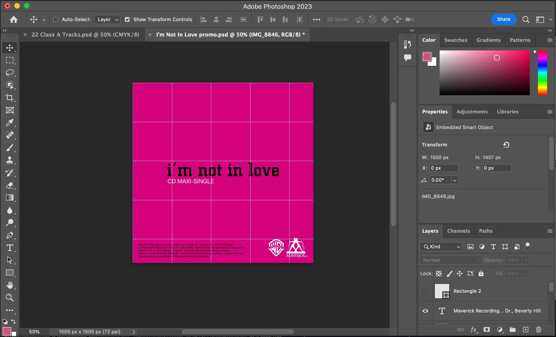

As you can see below, I have made a grid using the method of view > show > grid, and then made adjustments to the grid in an attempt to create it how I envision it should be. I am not sure how to make the size of each individual square equal so that the squares on the edge of the document are not smaller than the rest. I also want to place all the text boxes I created on top of the grid so they are not covered by it.

Thanks to everyone for their responses. I apologize for the delay in my reply. My biggest struggle with this is in getting the grid to be equal in width and height as it extends across the document space. I keep ending up with leftover space on one side of the document. I've tried a number of methods and haven't yet gotten it right. I've tried to make equal the number of pixels (all the way around a square) in the new guide layout, but the guides don't extend equally.
If the entire document is an even width and height (1500 x 1500 px), then I should be able to get even squares in that space to make a grid. 🤷🏻‍

I've used the exact same settings as you and I'm still ending up with larger rectangles in the middle of the pink square and smaller ones on the edges. Your example is exactly what I want to achieve.

The white margin is part of the image. The grid in your examples is entirely correct to your specifications.
To accommodate the white margin, you need a lot more than the 5 pixel margin you have set. Here it's 40 pixels in a 1500 pixel square document.

Do you want the grid to be even across the 1500px by 1500px or across the pink square? The pink square appeared to fill your canvas in your first screenshot, but it no longer does. We don't know the size of the pink square.

I'm sorry. Yes, the pink square is where the grid needs to be. The size of the pink square is 1408 x 1408 px. I tried to pick an even number for that.

I've tried both 46 and 44 and I end up with a little bit of space left over at the other side of the pink square. I keep making squares and just using the stroke as black with the interior color set to nothing. Screen Shot 2022-12-20 at 10.12.57 AM.png
