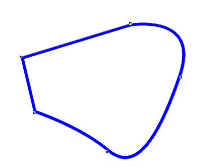

Hi! I am trying to stroke a path that is not closed. I would like only to have the stroke showing on the path and not between the endpoints of the path.
Is this possible? I am using Photoshop CC 2017.1.1 (2017.1.1 20170425.r.252 2017/04/25:23:00:00 CL 1113967 x64).
I first create a path with the Pen Tool, then create a Shape (click the "Shape" button on the Pen toolbar). Next, I use the Direct Selection Tool to turn off fill and to add a stroke. The results so far looks like this:
The problem is that the stroke appears also between the end points of the path. I would like the stroke only to be on the actual path, excluding the upper straight line between the two endpoints.
Is this possible?
    Correct answer davescm
    Check the options bar for combining shapes  Examples below:
    Dave

    You can achieve the same result by using the pen tool with Tool Mode set to "Shape". More info here: https://graphicdesign.stackexchange.com/a/155791/359

    davescmCommunity ExpertCorrect answer
    August 2, 2017
    Dave

    Excellent!
    Thank you!
